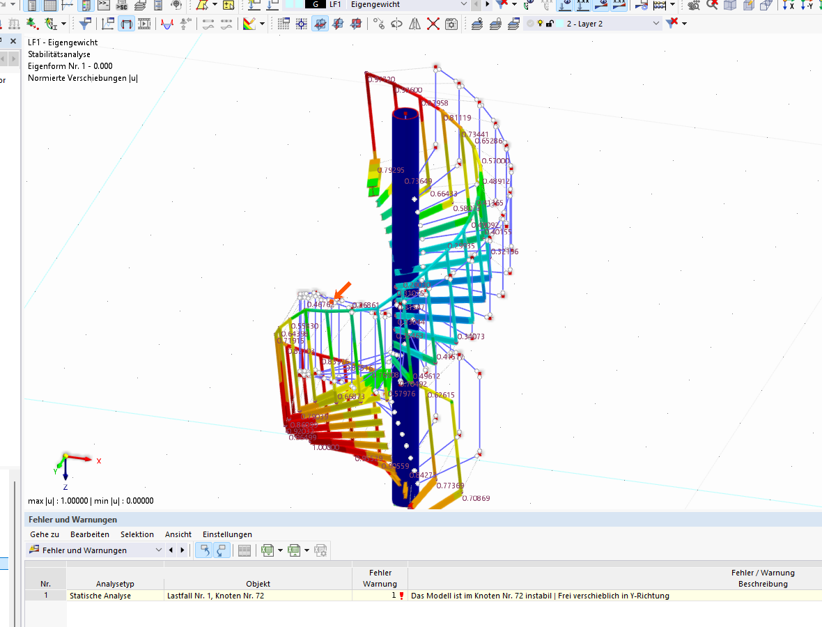

Hi everyone, we’re fairly new to using RStab and RFEM. I’m uploading a project for you to take a look at. Most of the nodes display an error message: “Free to move in the ... direction.” Unfortunately, we haven’t been able to find a solution to this. Thank you in advance.

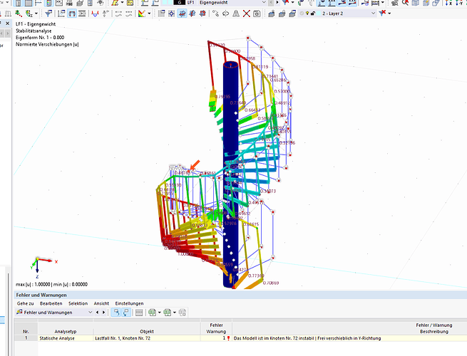

A little tip: The shape of the unstable model looks like this, and you should bear in mind in RSTAB that members are only connected if they split the member:
https://www.dlubal.com/de/downloads-und-infos/dokumente/online-handbuecher/rstab-9/003468

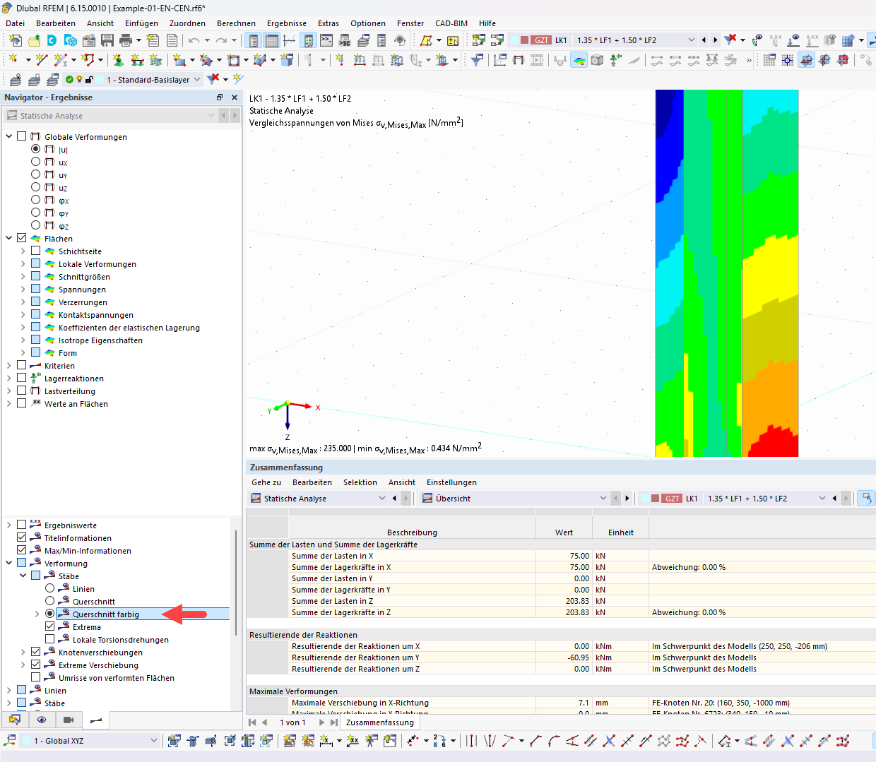

Thank you for the helpful assistance! Quick question: how do I set this up so that it looks similar to yours, especially the colors? In my case, only the deformations are displayed, so to speak.
T & C
Hi tozi_fh,
Thanks for your feedback.
You can control this here:
