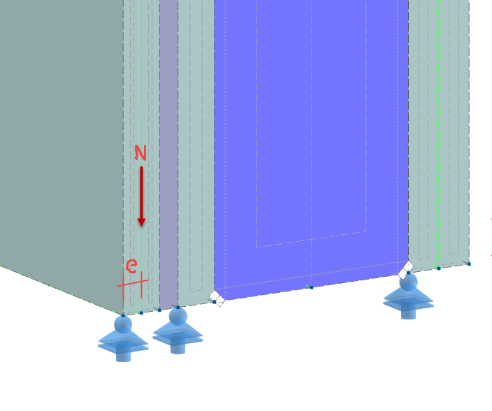

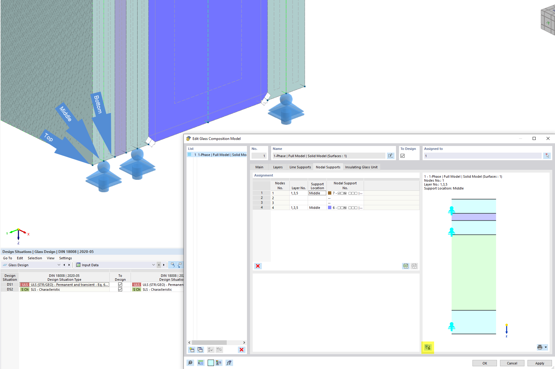

The support conditions can be placed individually, especially for glass construction, to also support individual layers. The supports are also displayed directly in RFEM to show you where they are arranged.
Top, bottom, or middle always refer to the surface side of the volume depending on the local z-axis of the volume.
The effects of the support conditions must always be considered individually and cannot be specified generically. For example, an eccentric support under normal force generates an additional moment in the pane.
To what extent this influence becomes significant must always be considered and assessed individually.
