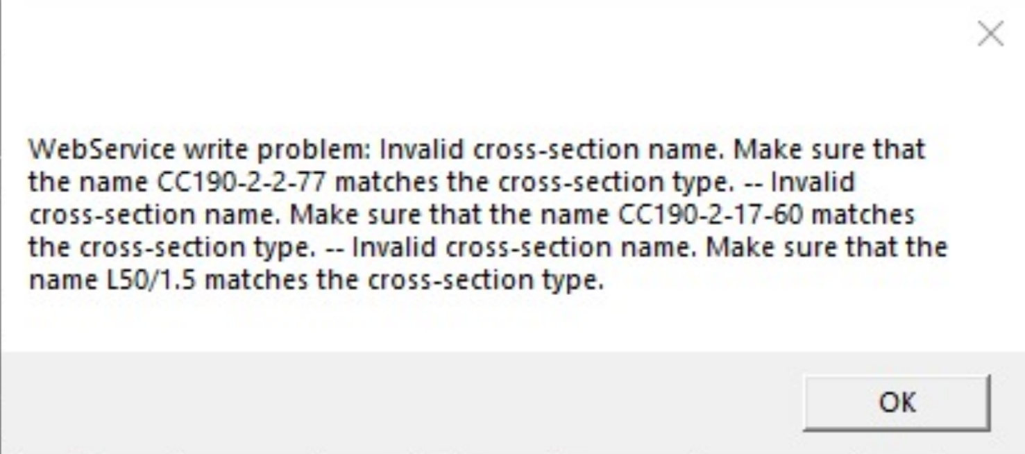

Hello, is it any a solution how to fix the issues with exporting of CFS profiles from Tekla to RFEM?

Hi VladyslavM,
usually, this kind of message is related to the conversion tables.
Please check your settings for the affected cross-sections. You can find the relevant information here:
:backhand_index_pointing_right: https://www.dlubal.com/en/downloads-and-information/documents/online-manuals/rfem-6-interfaces/003708
If anything is still unclear or the message keeps appearing, feel free to get back to us anytime! :blush:
