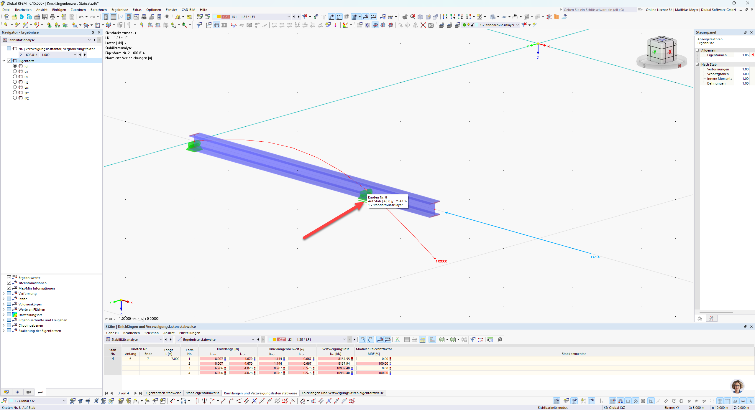

no, unfortunately that is not possible.
As an alternative, instead of grouping multiple bars into a bar set, you could use a single bar as a bar set and use nodes of the type "On Bar" within this bar.
