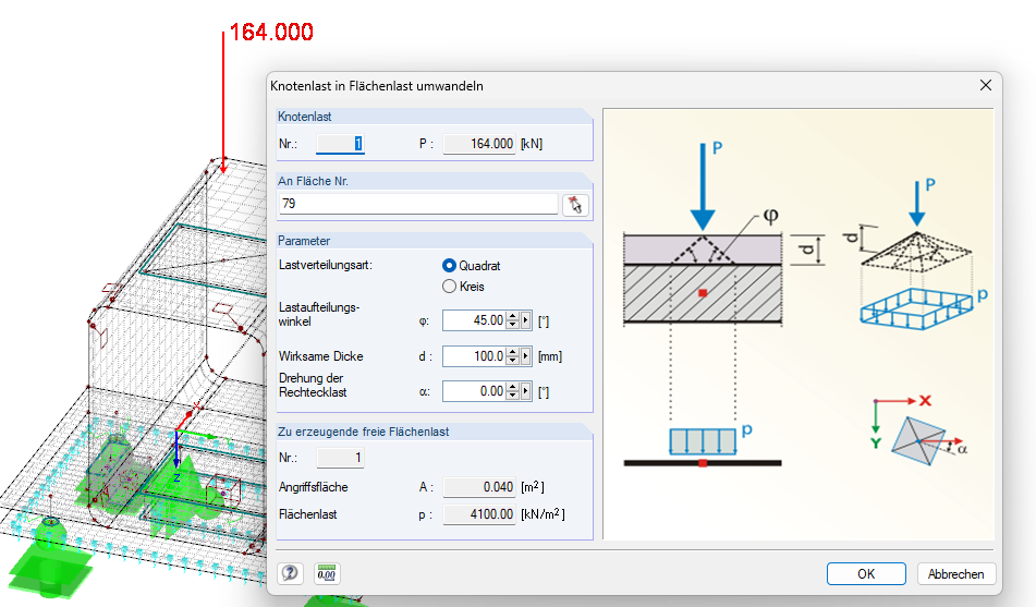

Convert point load to surface load
Where can I find this RFEM5 function “Convert nodal load to surface load” in RFEM6?

Hello @Flo6000 :waving_hand:,
This feature is currently not available in RFEM 6. However, I have noted you as an interested party for it.
At the moment, unfortunately, the only solution is the manual creation of a corresponding surface load.
If you have any further questions or need assistance, I am happy to help! :blush:
