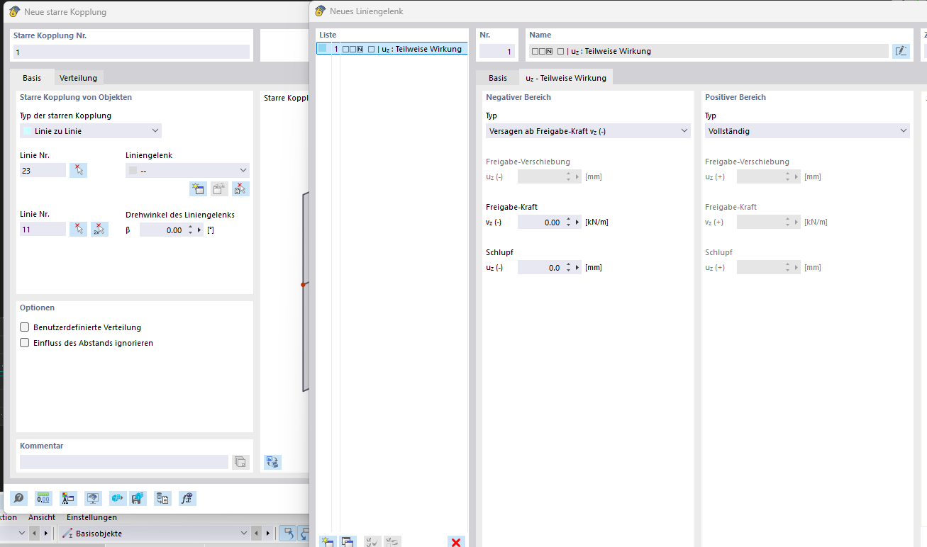

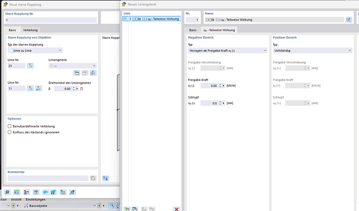

No, you cannot model slip this way via the coupling. The surface contact here basically behaves analogously to the contact volume. That means the contact takes effect immediately.
If you absolutely need a volume and must model slip, you can try defining rigid couplings between all the lines of your volume. Please see the following image and link.
