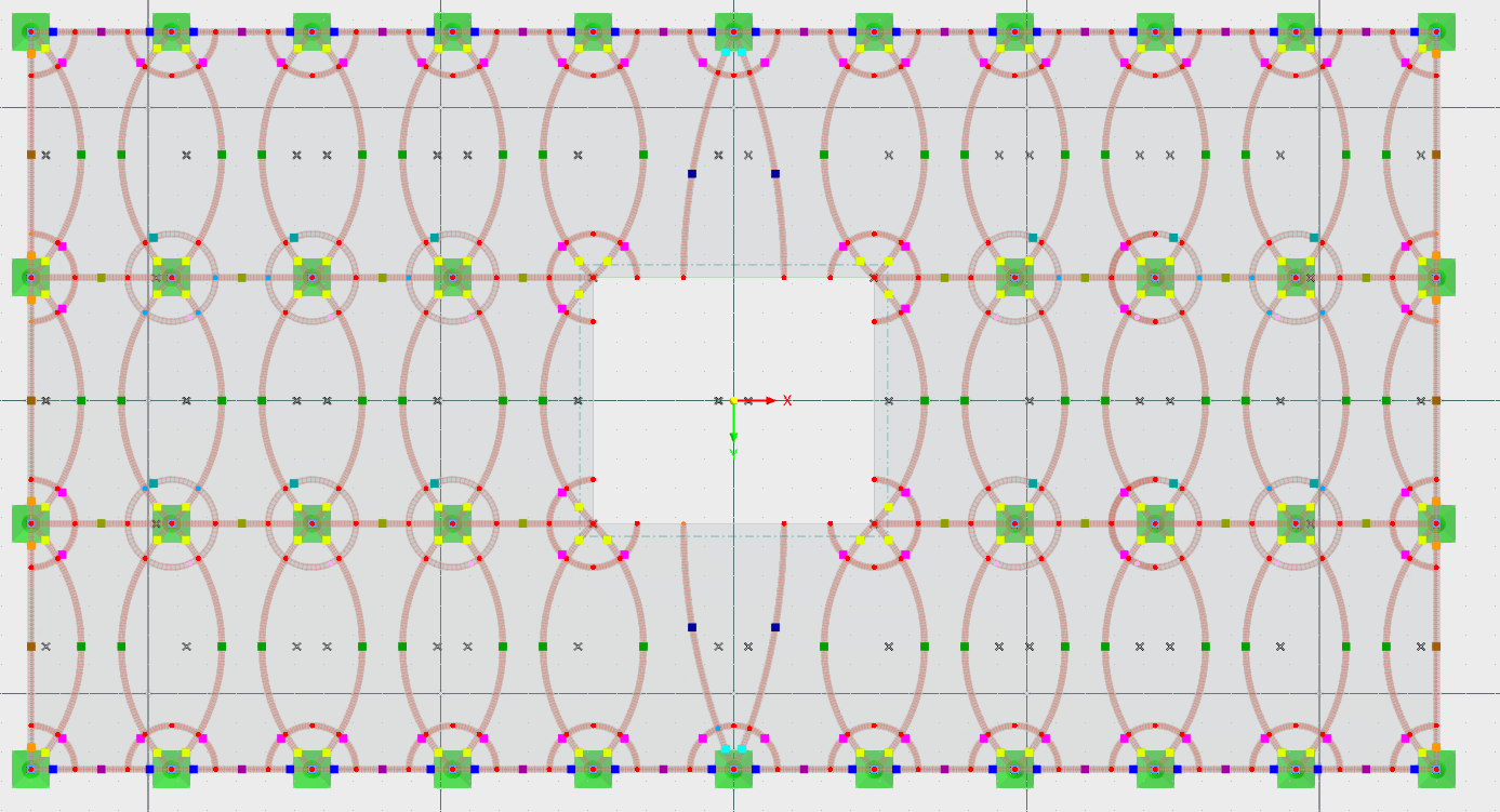

I want to design a force-flow-oriented ribbed slab with RFEM6. I have divided the ribs as follows:
grafik

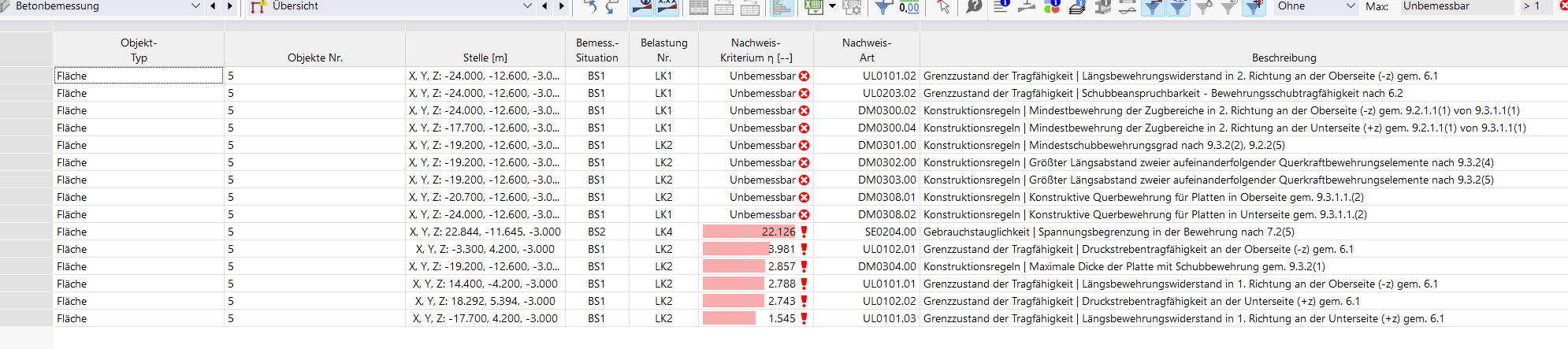

A thin reinforced concrete slab (7-10 cm) lies on the ribs. Can I design the slab without it being considered a load-bearing solid slab? Unfortunately, my verifications are clearly not fulfilled:
grafik

I assume that the brown bars represent the beams you are referring to.
Regarding the first question, I am not entirely sure what exactly is meant. I would need a few additional details here. In general, the following applies:
  • If the slab is load-bearing, it must also be designed.
  • If it is not load-bearing, then it does not need to be designed.
Designing the ceiling with line supports as beams would, in my estimation, lead to a significant underestimation of deformation. Therefore, I unfortunately cannot recommend this method.
