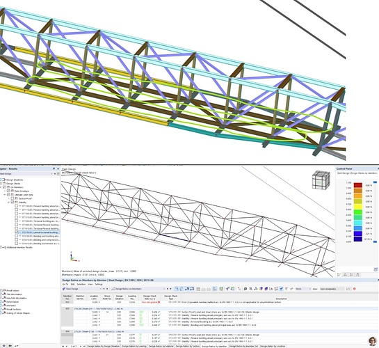

We have several RSTAB models where effective lengths are assigned to members, however the lateral torsional buckling checks are not performed for all the members.
The first image shows the model being rendered based on the effective lengths. It can be seen that the highlighted region all shares the same effective length and the section is defined as an I-section.

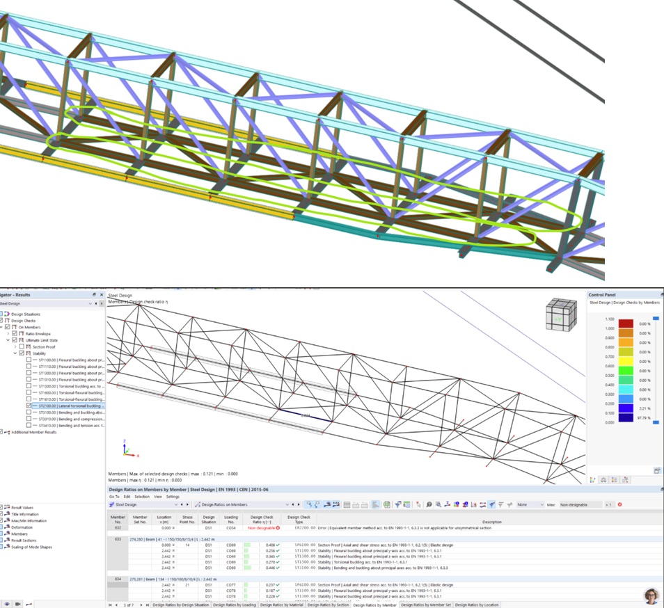

The second image is of the same view showing the utilization for lateral torsional buckling. This check is only being performed for a single member.
Why are the results like this? My expectation is that the lateral torsional buckling check should be performed for all the relevant members.
