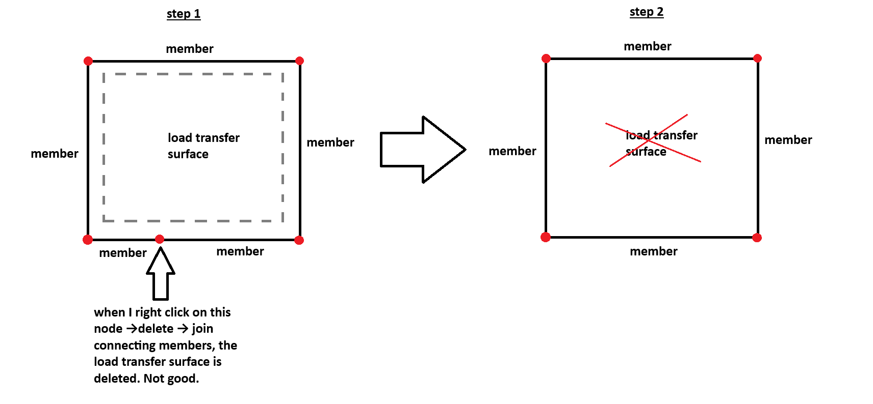

Situation: In RFEM6.12.0007, I have a load transfer surface, that transfers load to many members, including members that form its boudnary.
Problem: When I merge any of the members on the boundary, the load transfer surface gets deleted, as described in the image. This happens silently, with no warnings.
Question: is this is a bug, or a feature? if a feature, how to change the settings so that the load transfer surface understands the merger of its boundary lines and continues to exist.

I guess I found the problem: the node being removed was set in the surface window to be excluded from the influence of the surface. When I removed the node from that list, and then merged the boundary lines, the surface didn't vanish.
Great that you found a workaround. But it
works as expected on my example. To improve it, I need a file.
