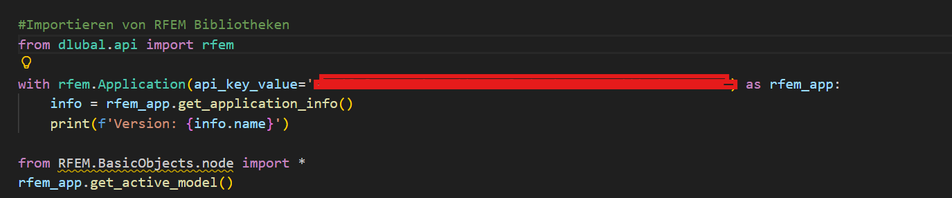

If I understand correctly, the API can now only be used if you generate such an API key, is that correct?
If yes, what would be best to discuss with my IT regarding the following error messages, in case they consider granting me access:

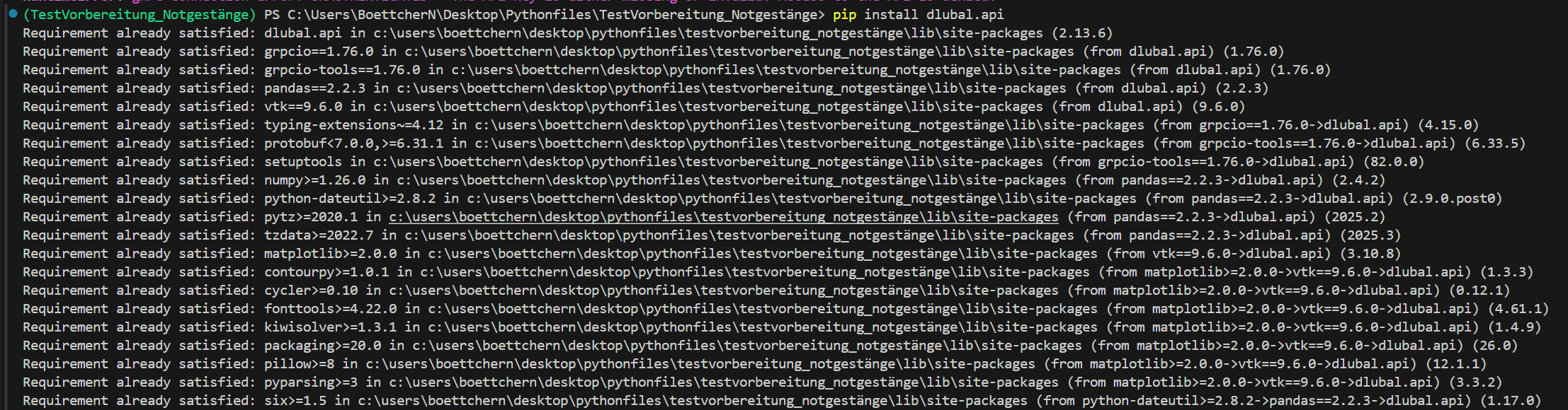

Regarding the API version, I have the following information:

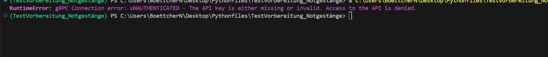

but now I receive the following warning message:
and this although the API key matches one that is shown to me on the Dlubal website under API 2.

please make sure that the version of the API (v2.13.6) is compatible with the Dlubal App (6.13.0001). So with v2.13.6 you should use 6.13.0006 instead or the other way around. Please try again after you changed this.
Which version of Python do you use?
