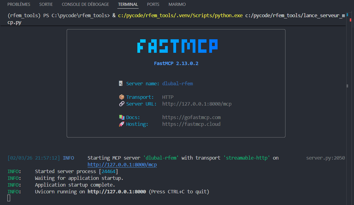

Okay,
So after following the steps in your answer, I understand that a config.ini file containing my API key was missing from the folder β€œC:\Program Files\Dlubal\RFEM 6.13\bin\Lib\site-packages\dlubal\api”
And now, it’s working :
Hooray!
No, time to try it !
Thank you for your assistance!
