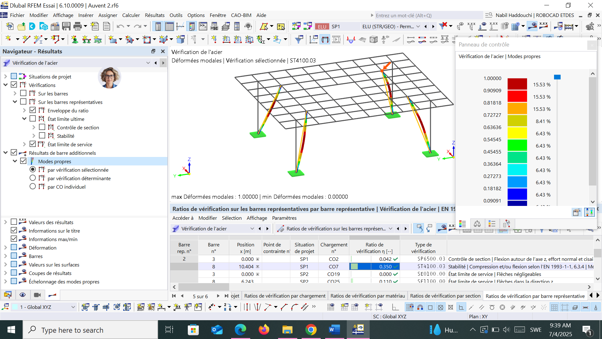

Hello again,

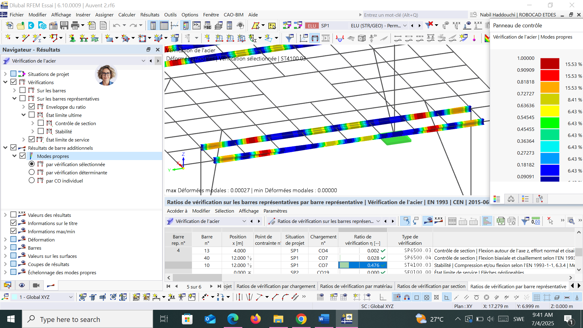

Please, what is the meaning of the scale of colors indicating the 'Mode propre'
Upove i select the 'barre representative 1'
I would like to understand the meanin of this screen shot abouve
Sincerly

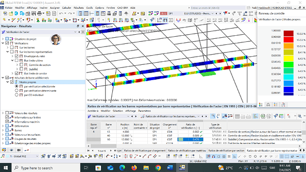

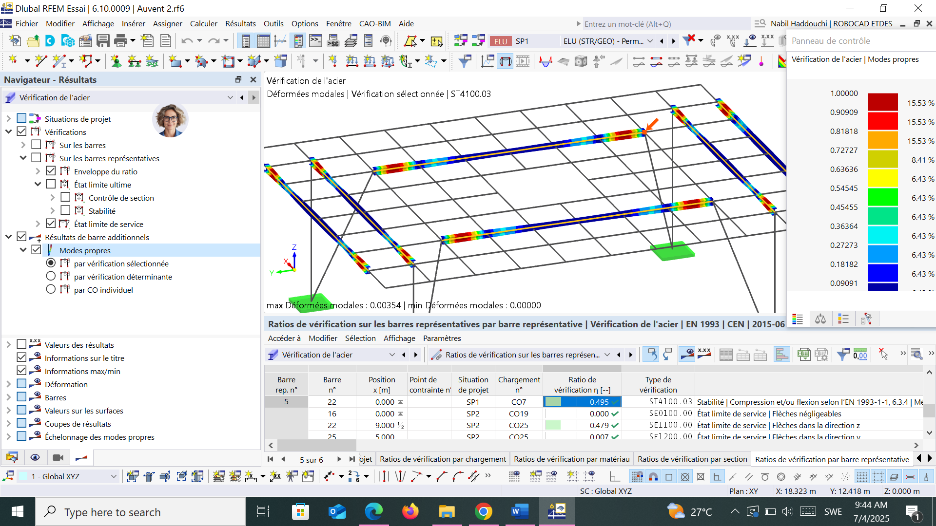

Hello again,
For 'barre representative 2' i have the following screen shot
Sincerly

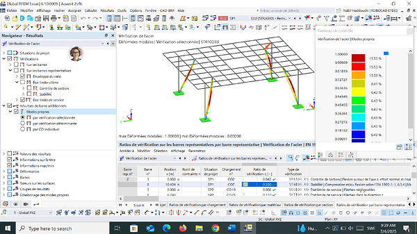

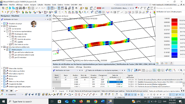

For 'Barre representative 4' i have the following screen shoot
Sincerly

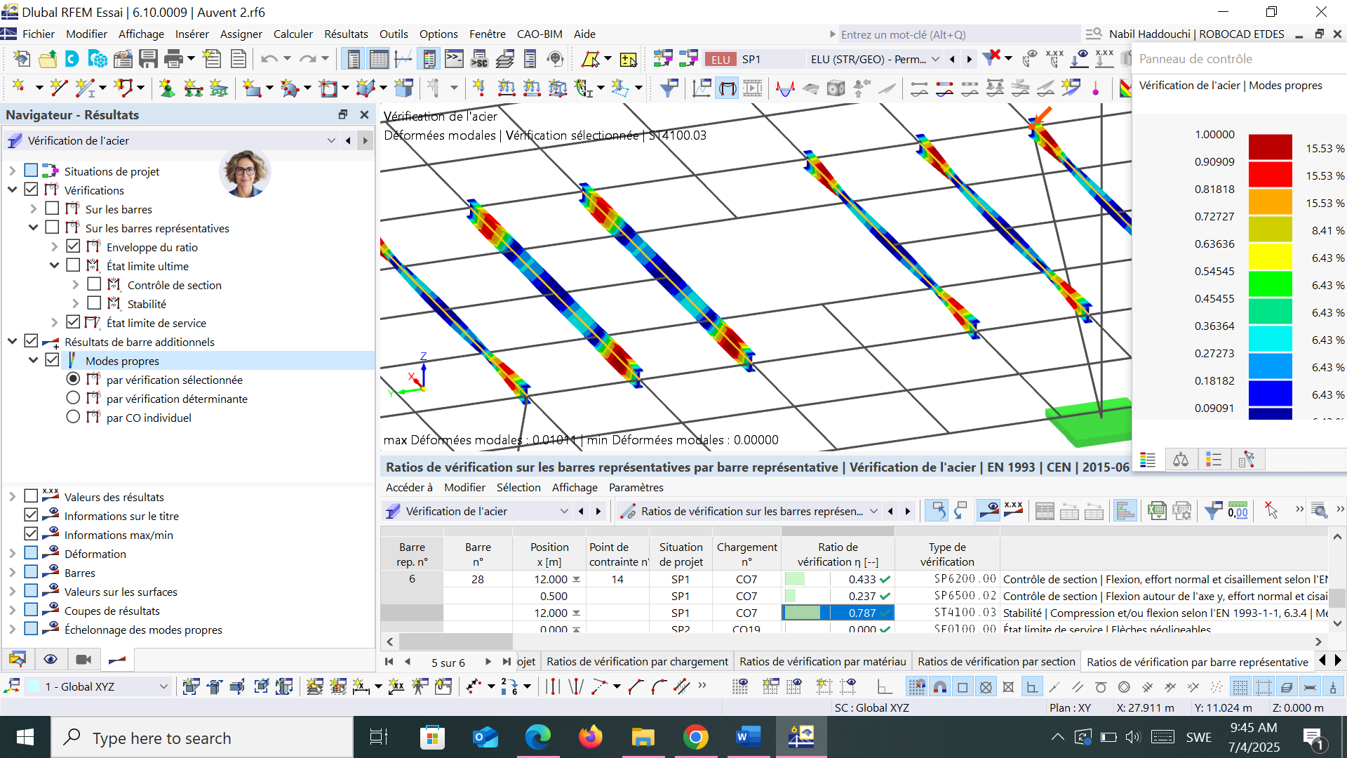

Soory the last message is for the 'barre representative 3'
Sincerly

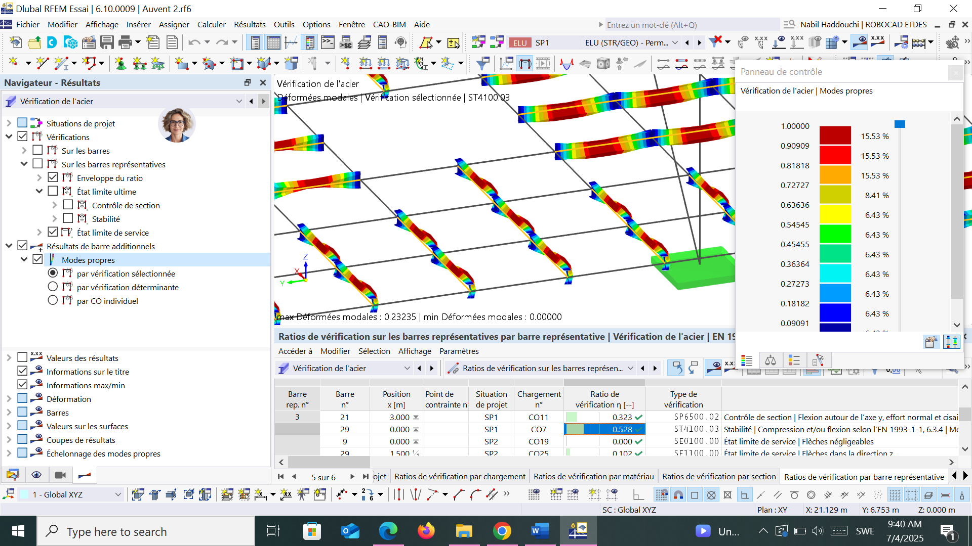

For 'Barre representative 4' the 'Mode propre' is shown bellow
Sincerly

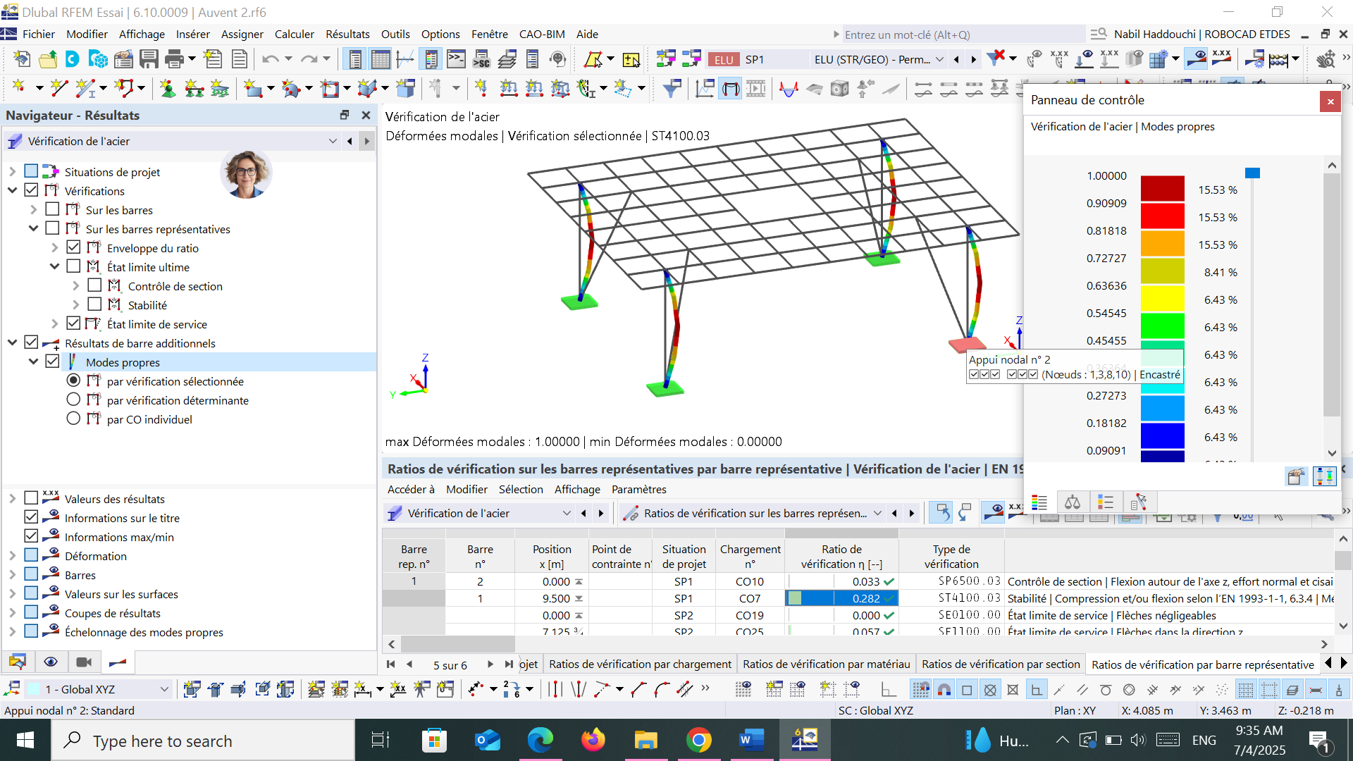

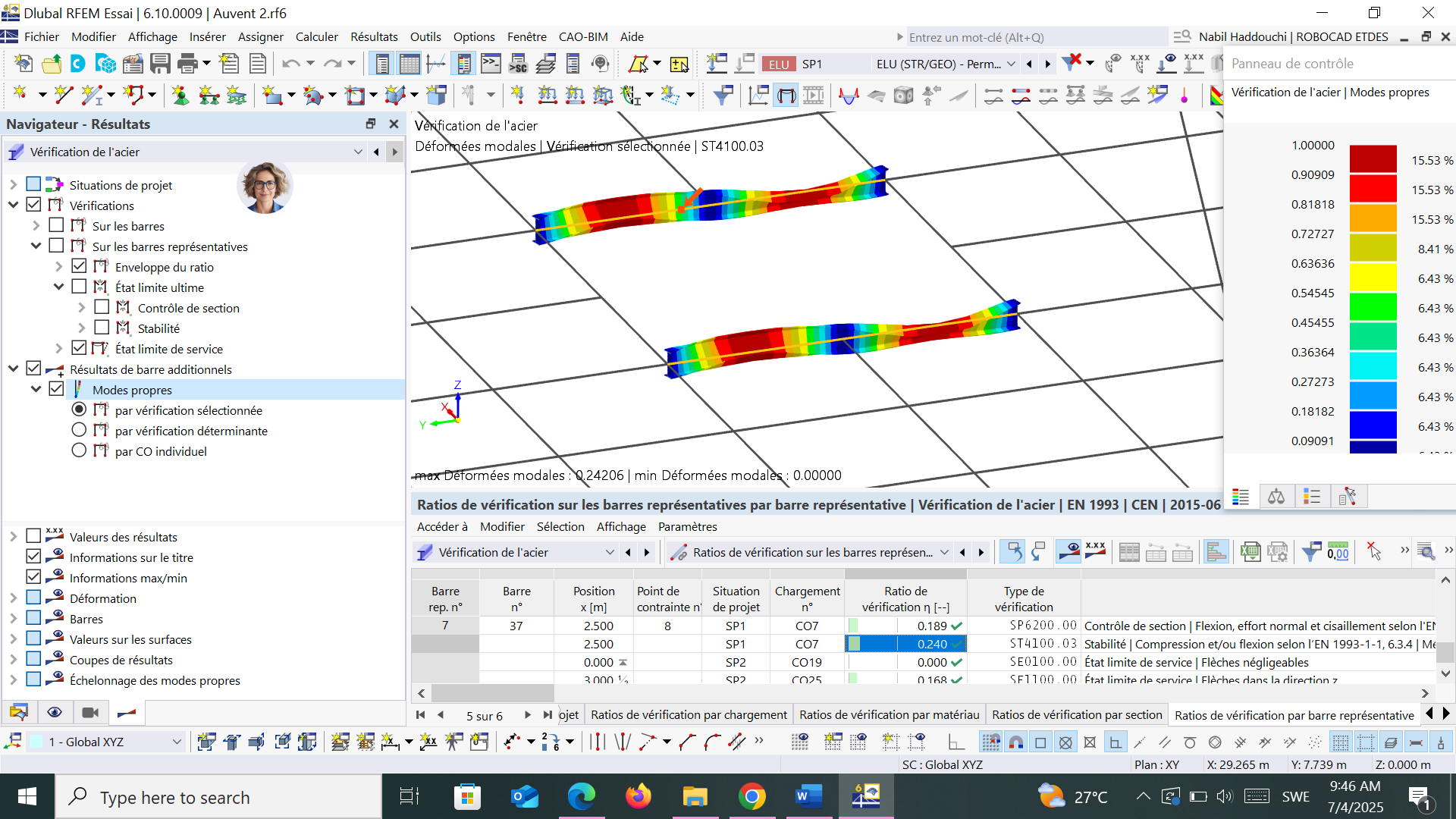

Hello again,
For 'Barre represetative 5' i get the following screen shoot
Sincerly

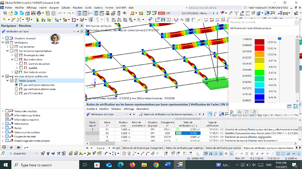

Hello again,
For 'Barre representative 6', i got the following deformation
Sincerly

Hi HADDOUCHI,
thank you for your inquiry.
The color scale indicates the relative deformation of the shown members due to stability failure. So, members or parts of members that are displayed red will fail first due to the largest relative displacement.
I hope that this makes it clearer for you. If you have any further questions, I'm happy to answer them.
