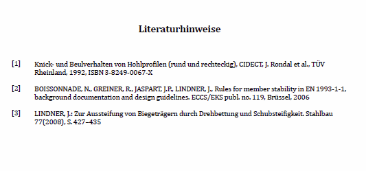

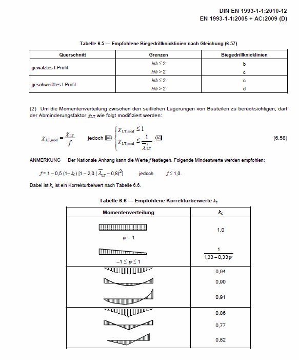

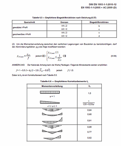

The following three images are excerpts from the standard, which give the indication that a reduction is possible due to the moment distribution. In the National Annex, reference is made to literature where further cases are treated beyond what is covered in the EC.
EC 3-1-1
EC 3-1-1 NA Germany

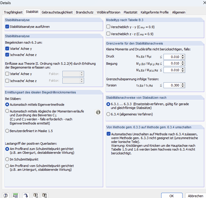

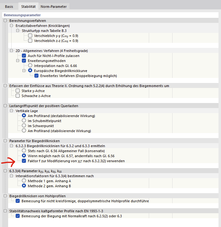

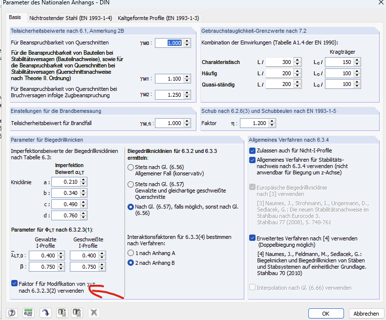

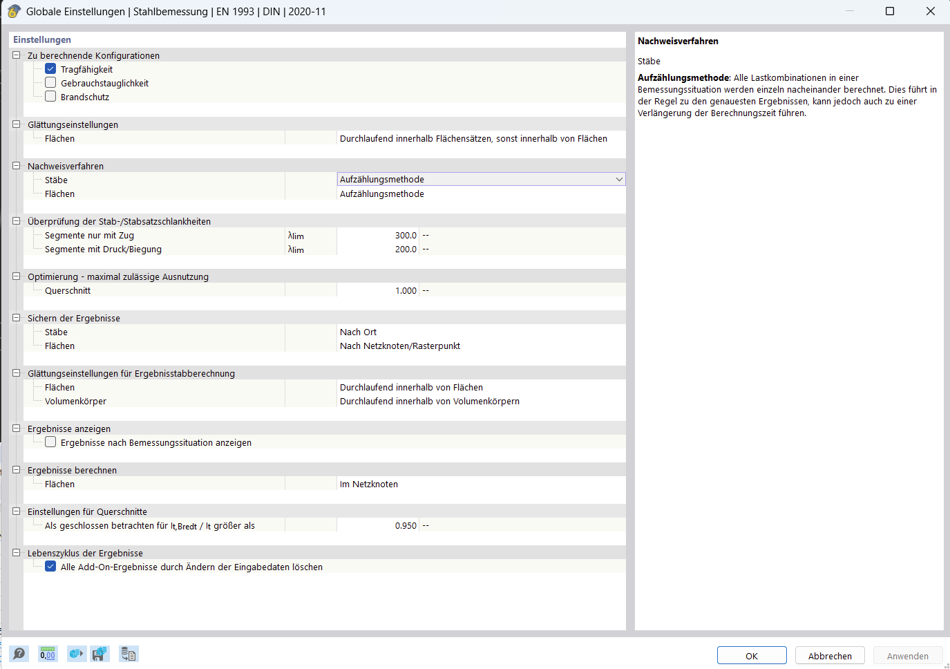

Below are my settings of the two programs. This concerns the same beam, same location, same support conditions, same internal forces. So everything is identical. The only difference in RFEM 6 compared to RSTAB 8 is the factor kc, which for whatever reason is set to 1.0, although the moment distribution is not rectangular.
RSTAB 8
grafik
RFEM 6
grafik
Hi Natsu,

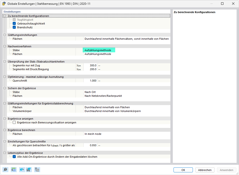

Please make sure that in your model for the steel design the enumeration method is selected in the global settings.
If the envelope method is chosen, no exact calculation of k_c according to EN 1993-1-1 Table 6.6 is performed in RFEM 6. In this case, k_c is always assumed to be on the safe side with 1.0.

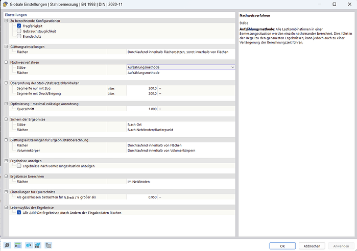

Hi Niklas
Sorry for the delayed response. I just read the message now.
The numbering method was already set in the global settings beforehand.
Is there another menu item that influences this coefficient?
Regards
Natsu
Hi Natsu,
There is no further setting that influences the calculation of the coefficient k_c – apart from the option you have already found in the load-bearing capacity configuration:
“Use factor f to modify X_LT”
The reason that k_c is set to 1.0 in your case is most likely because the existing moment distribution along the member cannot be clearly assigned to one of the cases specified in EN 1993-1-1 Table 6.6. :warning:
