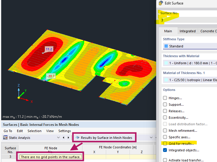

No results in "Results by Surface in Mesh Nodes" table
I have no results in Results by Surface in Mesh Nodes and get an info Ther eare no grid points in the surface
Is this expected? Is it really necessary to have Grid for results.. turned on to retrive results in Mesh Nodes in table ?
I work with RFEM 6.12.002
Hi Sajdak,
Unfortunately, yes, it looks like this is a bug. I've already created a bug report for this issue (ID: 585130).
Thanks for bringing this to our attention! Let me know if you need anything else. :blush:
Matthias
