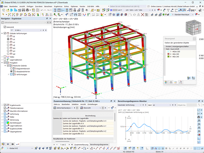

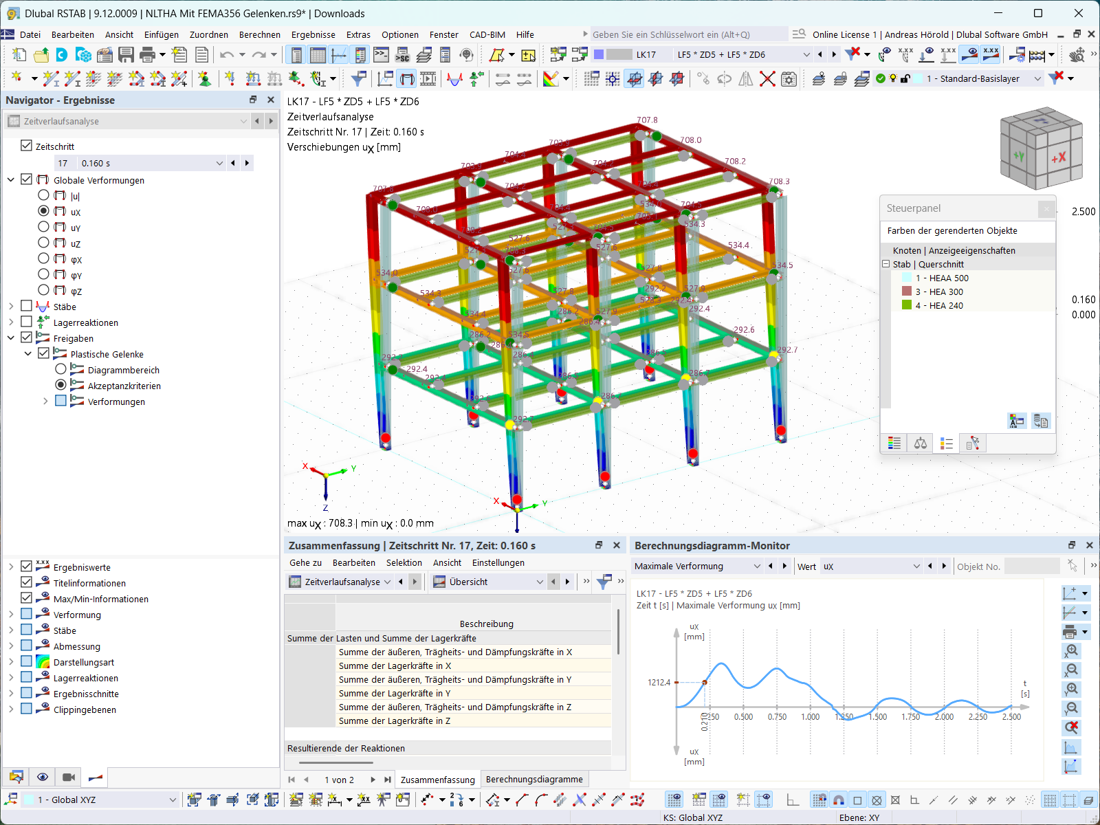

we are planning to improve the functionality of our nonlinear seismic design tools. We have just released the Nonlinear Time History Analysis:
as well as nonlinear Reinforced Concrete hinges (flexure) according to ASCE 41-17:
https://www.dlubal.com/de/support-und-schulungen/support/produkt-features/003103
