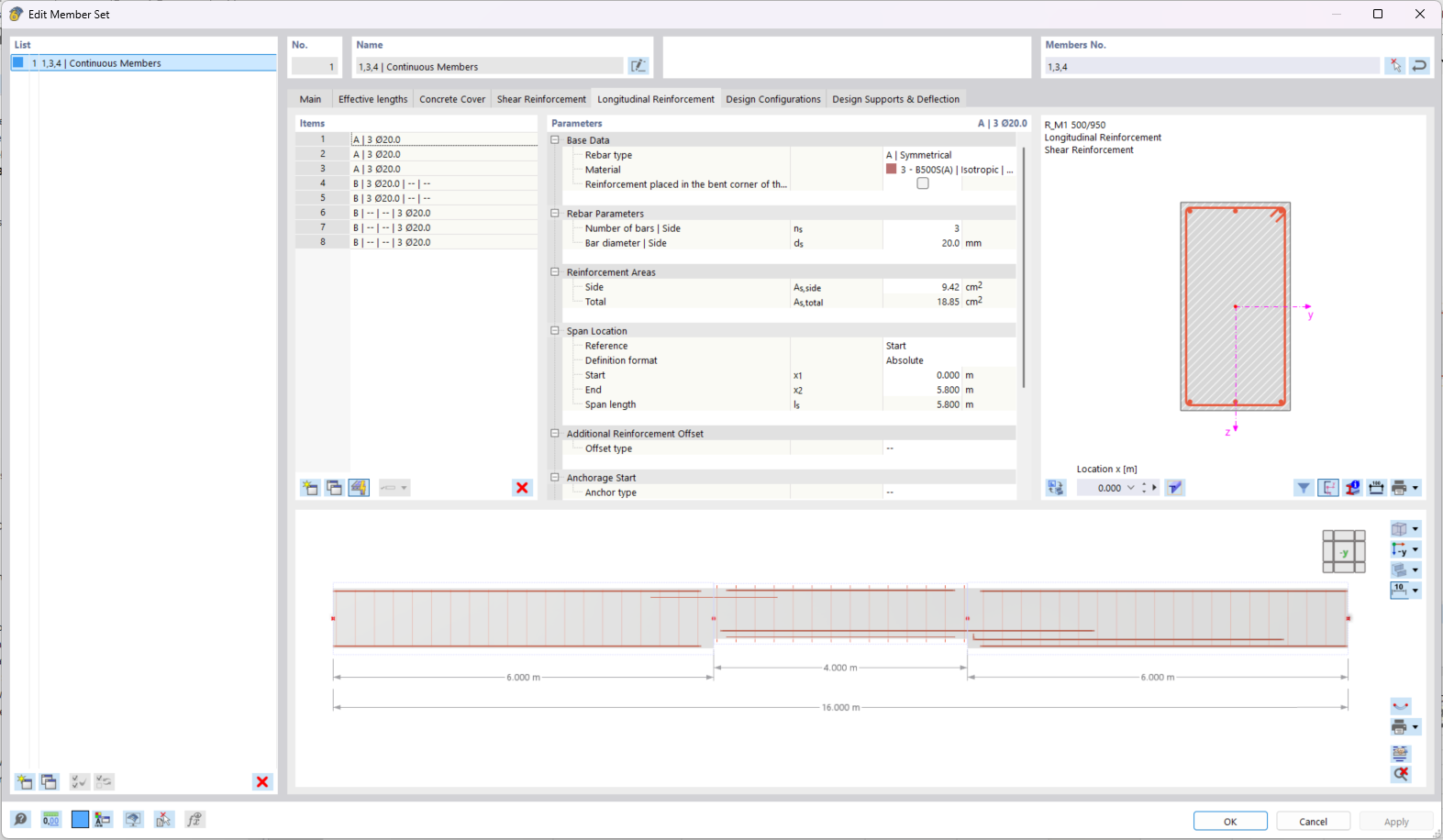

@clemens.gutmann Sorry to bug you about this, but I'm not sure about how to model this kind of case using Dlubal.
I believe deflection analysis would require a member set to work, but using a member set also leads to loosing granularity over the rebar configuration.
Hello @FredericBourgeon :waving_hand:,
I would still recommend using a member set in this case. For the reinforcement design, you can define different longitudinal rebars and stirrups in different segments along the member set.
Also, we are currently working on improving and optimizing the reinforcement definition for member sets consisting of non-uniform (inconsistent) beams.
