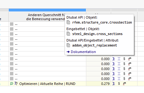

I would like to use the cross-section optimization of the steel design module of RFEM 6 via the Dlubal API.
grafik
The tooltip suggests that this property can be set directly during the cross-section creation via addon_object_replacement. Unfortunately, I cannot find any documentation on this and therefore suspect that it is not yet available.

the optimization has not yet been implemented as you suspected. But via the API you can easily run a loop and build your own "optimization". I think you can quickly achieve the desired result with little effort.
I have added you to the list of requesters for this feature in the API, I hope this is of interest to you. Should there be any news on this topic, we will spread them through the known channels.

You are absolutely right, I just hoped to have it a bit easier and require fewer requests :slight_smile:
