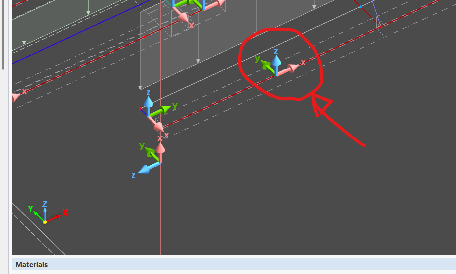

Situatoin: I use the legacy C# API to read the model data from RFEM 6.
My Need: I need to read the x,y,z vector coordinates of each of the local x,y,z coordinate axes of members, i.e. a vector(x,y,z) for each of the three local coordinate axes, as marked in the image.

Quesiton 1: How to access the coordinates of each of the three local coordinate axes of the member?
Hi PSA001,

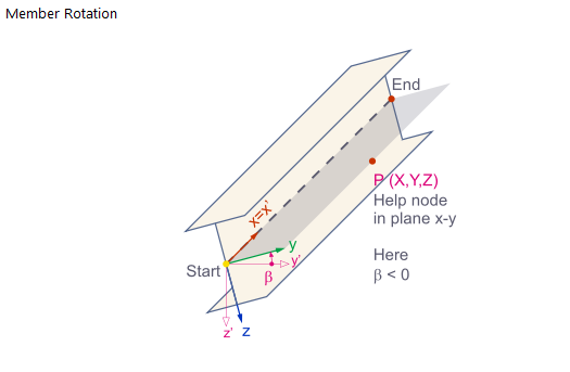

Unfortunately, there is no out-of-the-box solution for this. However, each rod has a starting point and an end point, as well as a twist angle beta. With this information, you should be able to calculate the desired data.
