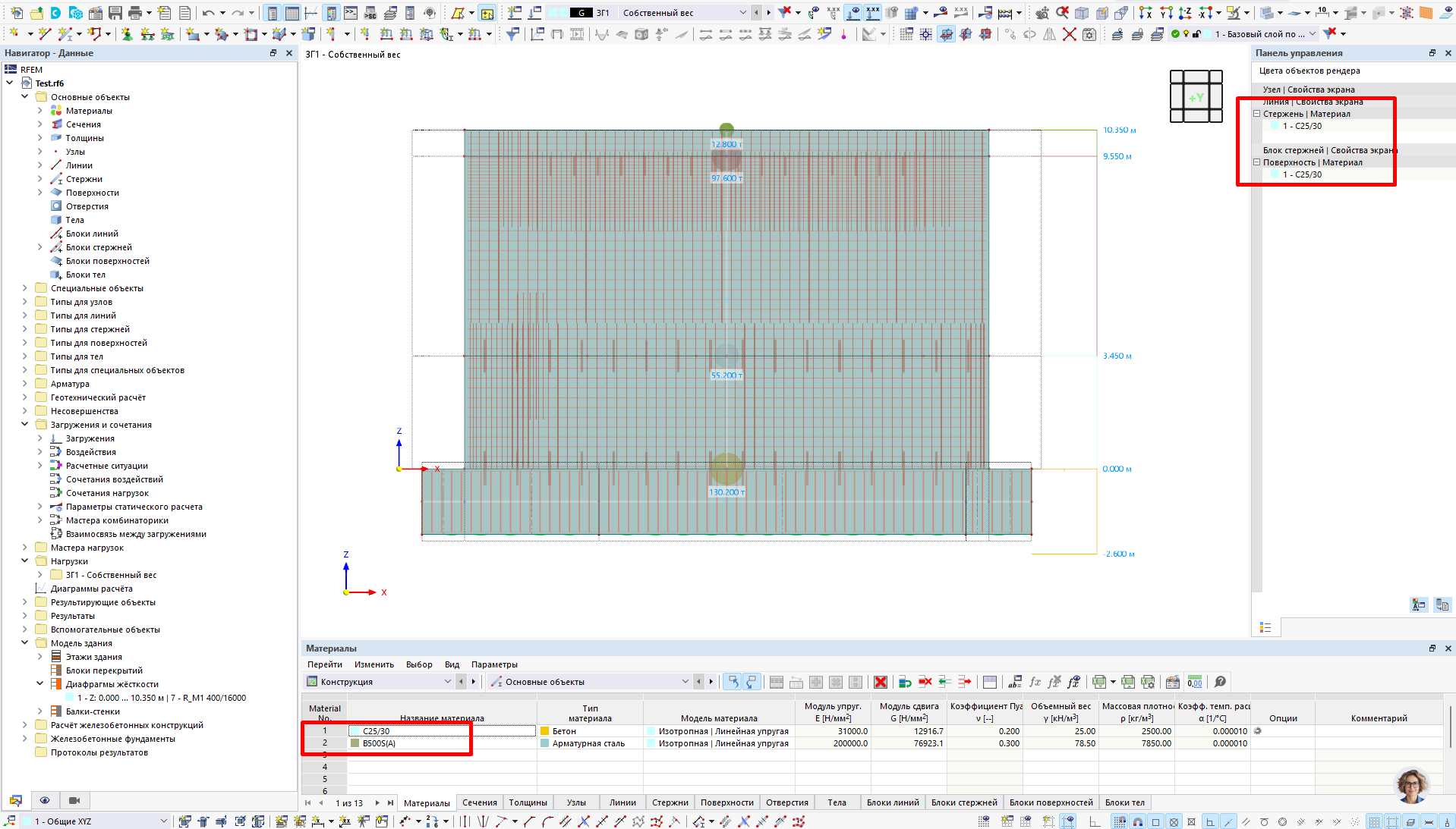

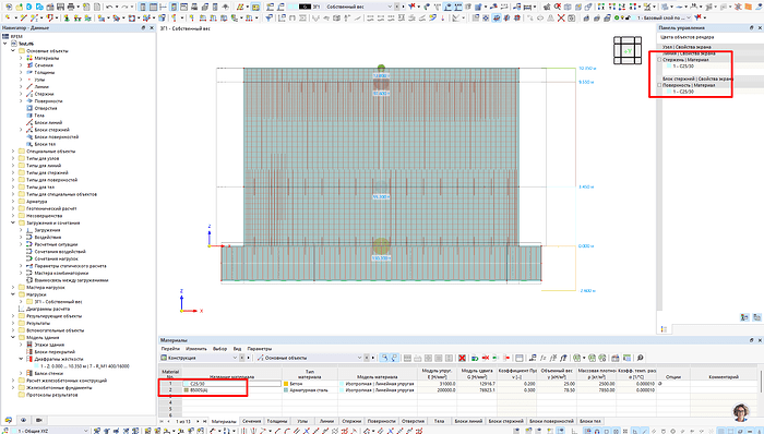

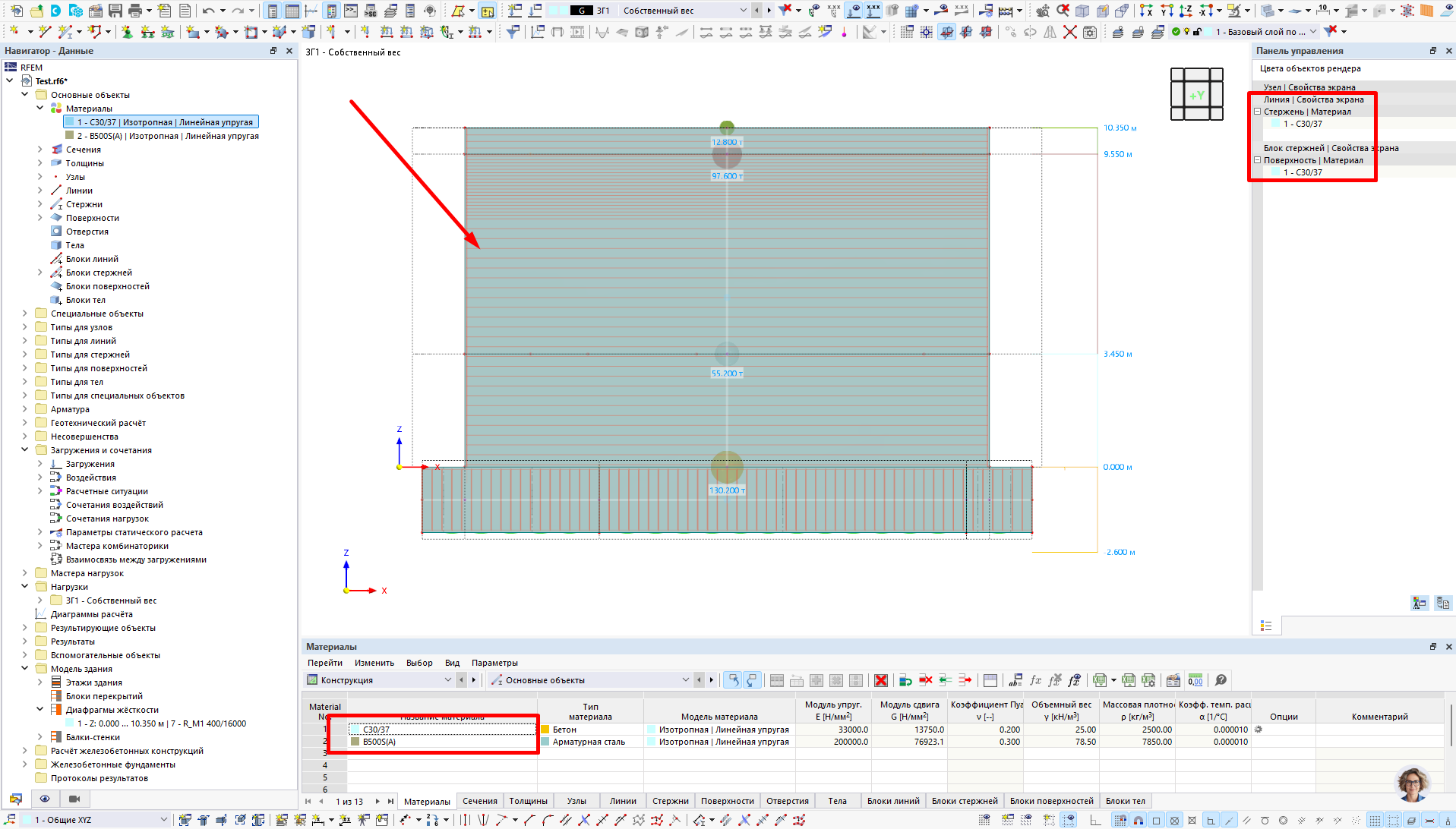

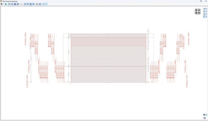

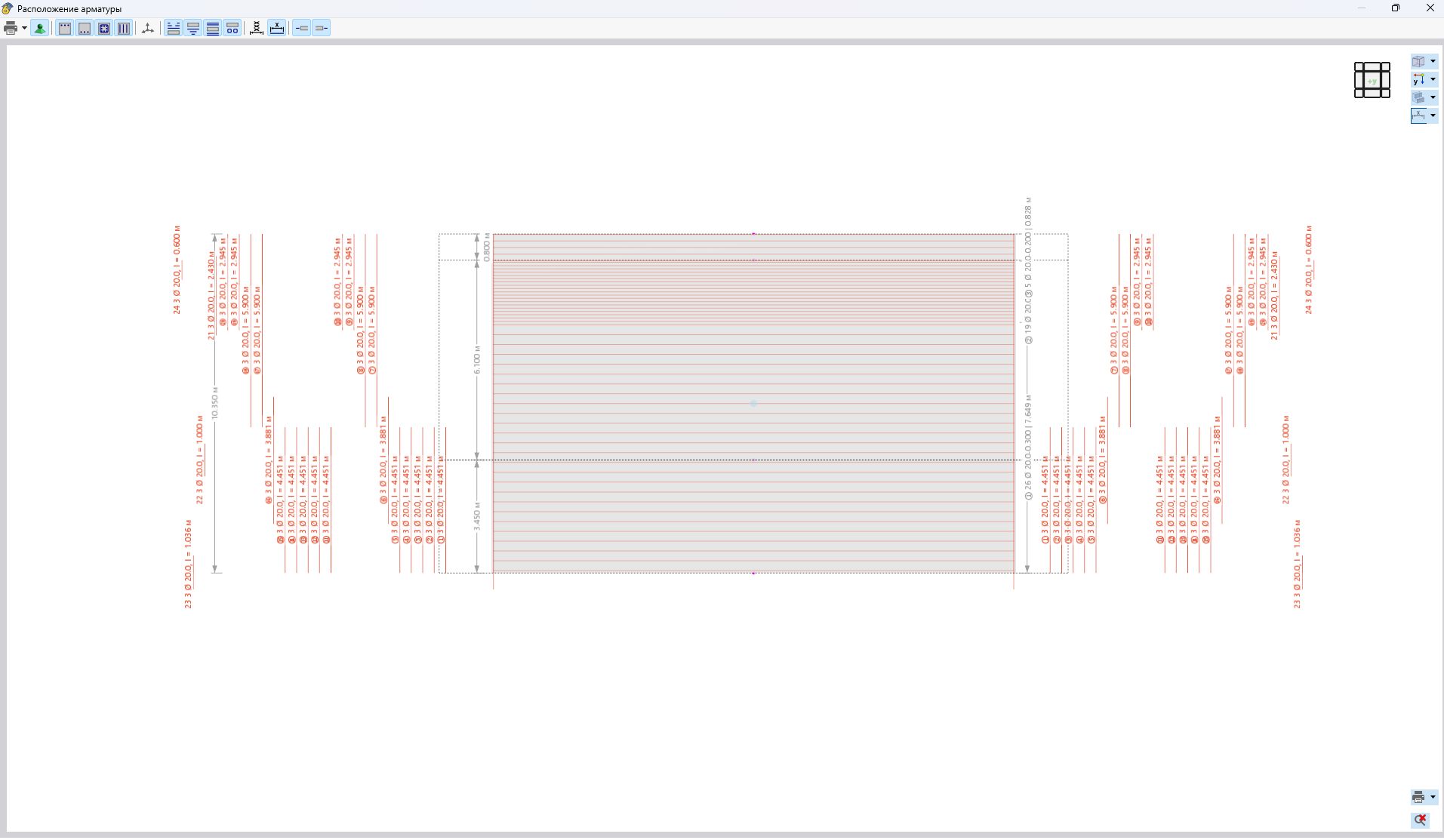

Hello. When the material changes (for example, the class of concrete or reinforcement), the specified reinforcement of the diaphragm-stiffness changes. Is it unclear if this is a mistake or am I doing something wrong?
After changing the material

Hi Сергей,
I guess this is an unexpected behavior. I passed it to the development team to have a deeper look into it. Thanks for sharing.
As soon I have some news about this topic, I'll post it here.
Hi Сергей,
Good news, the error has been fixed. Please try with the current version of RFEM.
