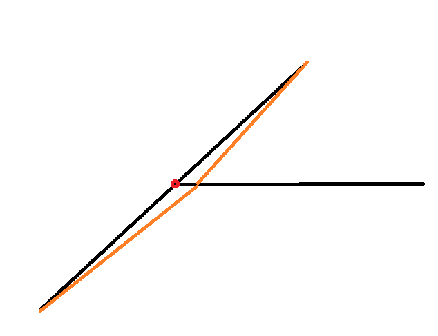

My main concern is intersection of non-orthogonal lines. To how many decimal places can I round the intersection point coordinates without changing the actual line geometry or causing connectivity problems in RFEM 6? In short to avoid getting the orange line.

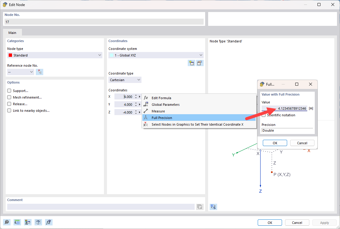

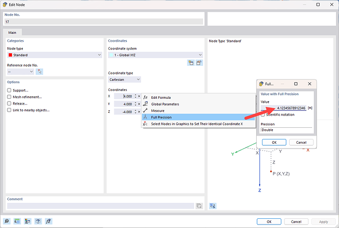

Hi mejra,
You can check the full precision at the nodes - there should be up to 14 decimal places:

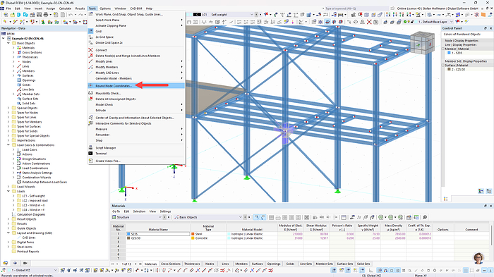

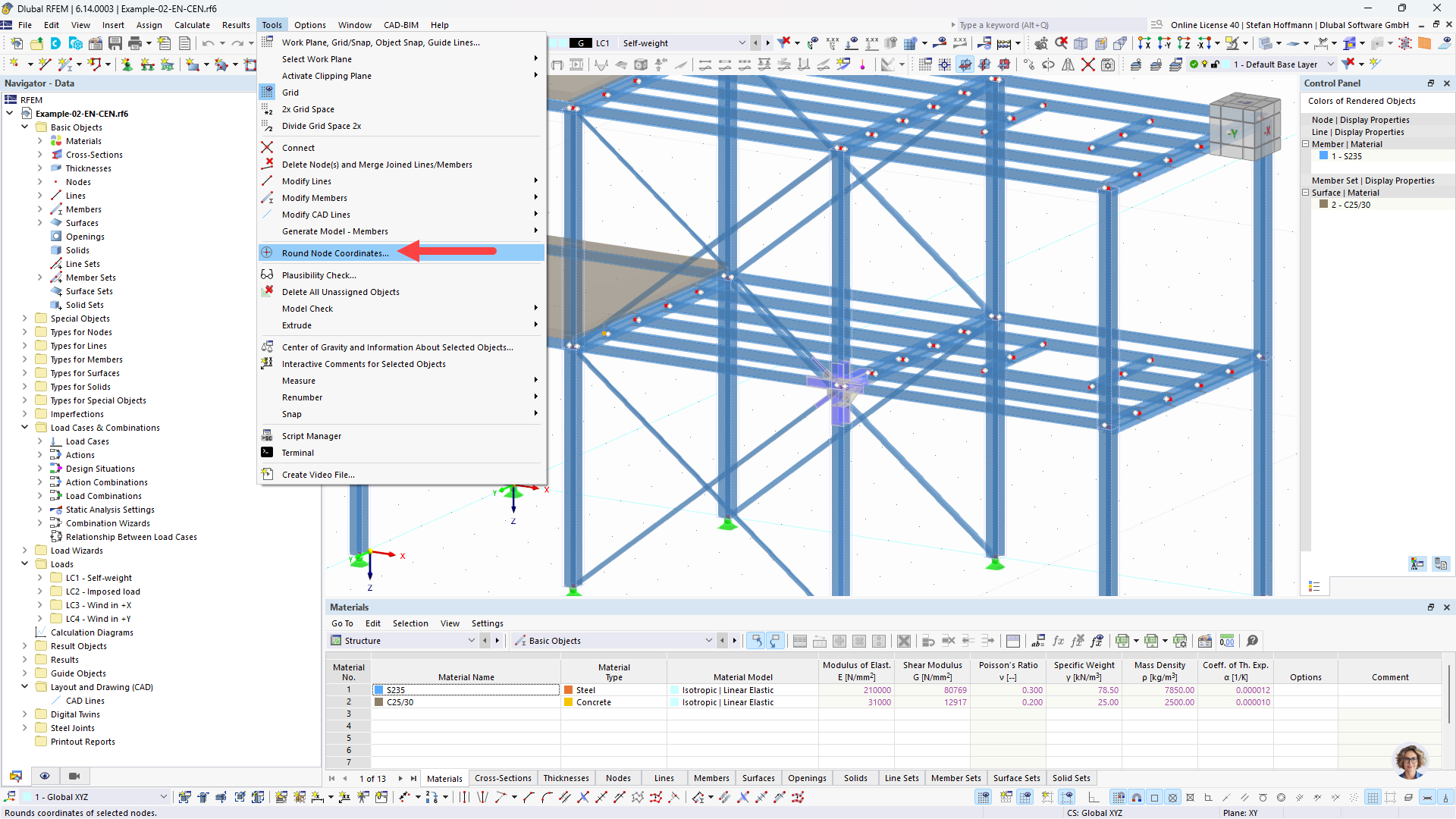

So it’s not always necessary to model with exact precision down to the last decimal place.
Also note that computers work with floating-point numbers. Rounding can be applied here if needed:
