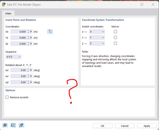

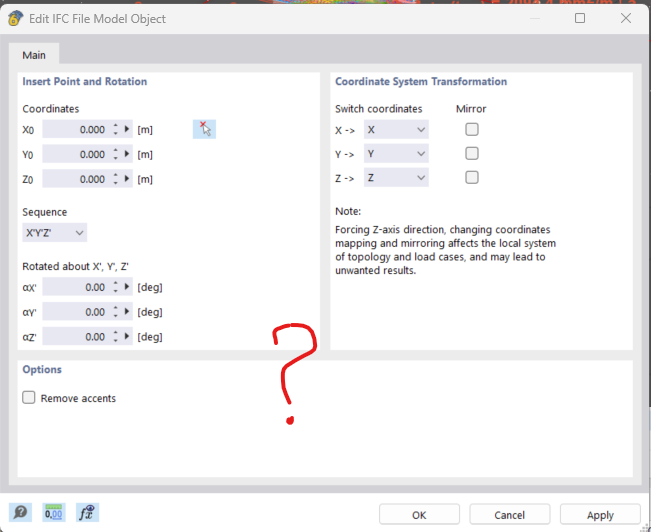

When I export my concrete structure containing the designed rebars as an ifc file, the rebars are not exported.
Am I missing something? or is it not possible to export the rebars as an IFC file or to a BIM model?

Unfortunately, rebars cannot be directly exported via the .ifc file format. However, you can use the 3D .dxf export as an alternative. For more details, please refer to the following link:
3D .dxf Export Guide
If you're working with Allplan, you can export the surface reinforcement using the .asf file format. For more information on this, check out the link below:
Surface Reinforcement Export in Allplan
I hope this helps! Should you have any further questions, feel free to ask. ![]()
