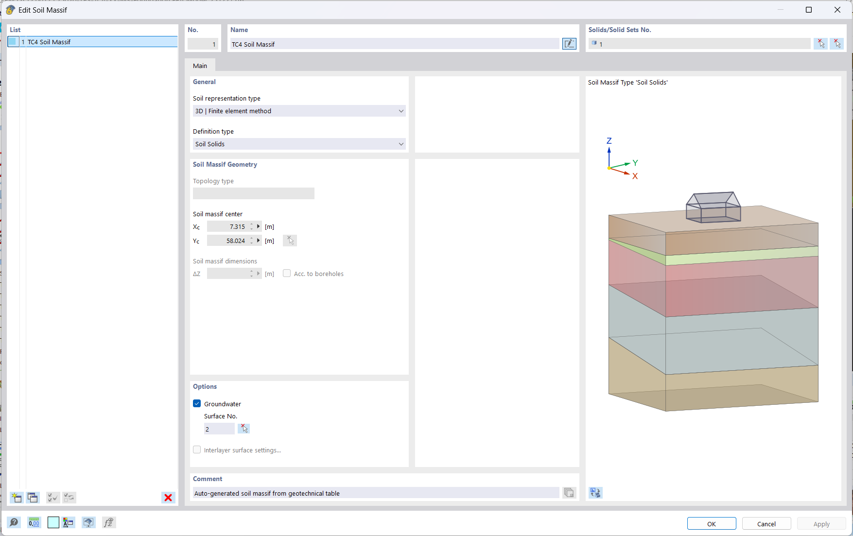

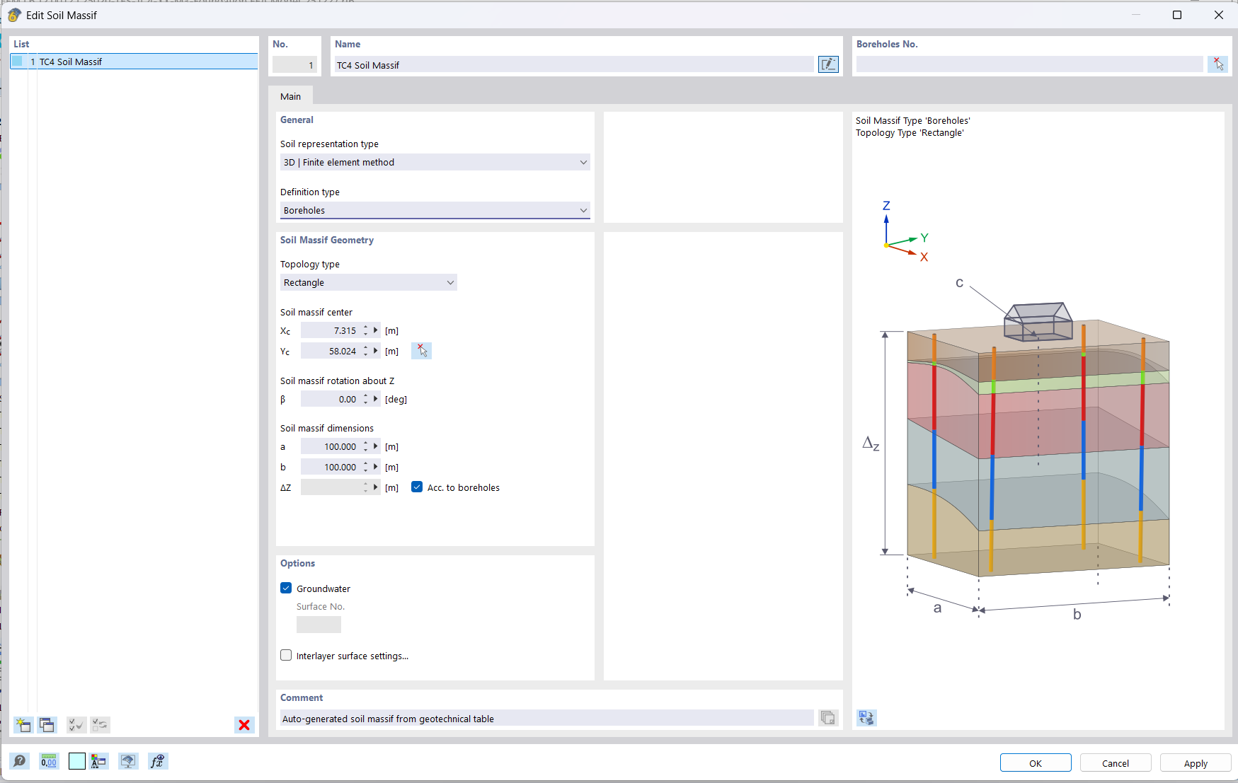

But when I go into the RFEM6 UI, it has definition type = Soil Solids (I want it to be Boreholes). I assumed that assigned_to_type=RFEM.geotechnical_analysis.SoilMassif.ASSIGNED_TO_TYPE_BOREHOLESwould have made it Boreholes?
When I change to Boreholes, all the info that I had from my api command seems to be saved (ie the size, but not the Borehole No., although from my log I know its using the correct borehole number).

Update:
I realised that it was auto changing to be Definition Type: Soil Solids once I edit the created solid to have my surface as an integrated object (as when I commented out this code the soil massif definition type was Borehole). I guess there is no issue with it changing to soil solids.
My new issue is that while it calculates when the soil massif is 30 x 30 meters, it doesn’t calculate for 100 x 100 meters? Could I send my model privately to someone from dlubal to check out why?
