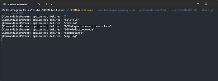

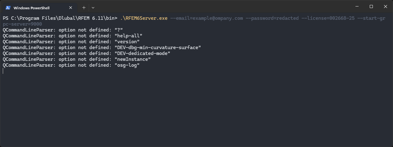

I am trying to start the RFEM6 server with the following command:
.\RFEM6Server.exe --email=example@example.org --password=123 --license=000005-25 --start-grpc-server=9000
Then the following error appears:
Expected behavior:
  • The RFEM6 server should start and provide the gRPC server on port 9000.
Actual behavior:
  • An error occurs. (See screenshot)

Hi hasslernils,
in principle, you are already proceeding correctly. That is exactly how it is described in the corresponding FAQ:
However, I can confirm your observation, as the same error occurs for me as well. Unfortunately, I cannot tell you why. Therefore, I have informed our development department and requested an analysis (Bug 543973).

Hi hasslernils,
the whole thing was a bug (543973), which should have been fixed with this week's version (6.12.0009).
Clemens Gutmann

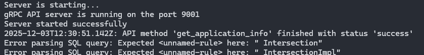

Hi Clemens,
thanks for the update.
With the current version, it is running again:
Let's hope it stays that way in future versions! :)
