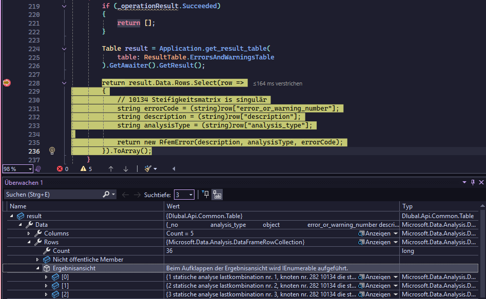

I have a method that reads the ErrorsAndWarningsTable after a failed calculation to obtain information.
For example, when calculating a model, error 10134 can be read out and provides information about the calculation status.
When I run the method with RFEM, everything works as expected.
However, if I calculate the same model with RFEMServer, the table remains empty.
In both cases, the calculation was faulty. Below are some screenshots showing the behavior.
Result with RFEMServer
Rows.Count = 0
Pasted image 20251215115706
Result with RFEM
Rows.Count = 36;
Pasted image 20251215120202
Line that causes the error:
Table result = Application.get_result_table(
	table: ResultTable.ErrorsAndWarningsTable
).GetAwaiter().GetResult();

Hi hasslernils,
I was able to reproduce the issue with version 6.12.0010 and 2.12.10, so created a bug (Bug ID = 562685) and sent it to the development team.
As soon as there are some news about this issue I'll let you know.
Hi hasslernils,
this issue should be solved with the latest version (6.13.0009 / 2.13.9). Please give it a try.
https://apidocs.dlubal.com/release_notes.html#id1
Thanks for the update!
