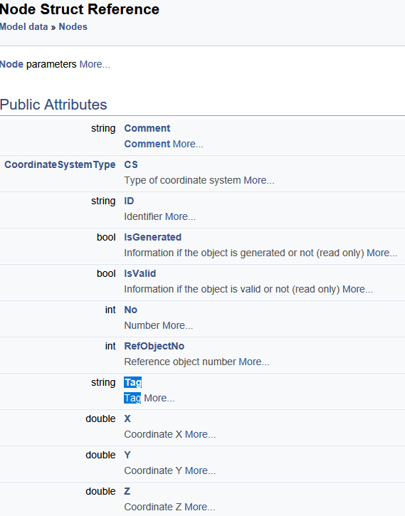

in RSTAB 8, the new Tag field was introduced, which could only be accessed via the RSCOM API. We used this field, for example, to set a part assignment (integer number) and to read it out again later. We already use the Comment field for other meta-data and therefore it is not available for this purpose.
grafik
Can the Tag field for nodes and members be used/enabled again for RSTAB 9 as well as gRPC? This would help us a lot.

As you noted, the field is not available in any of the Dlubal apps (RFEM, RSTAB, and RSECTION). There is already a request for this feature from other users, the corresponding RUS ID is 5233. I have added you to the list of requesters; I believe this is in your interest.
As soon as there is any news on this topic, you will be informed through the usual channels.
