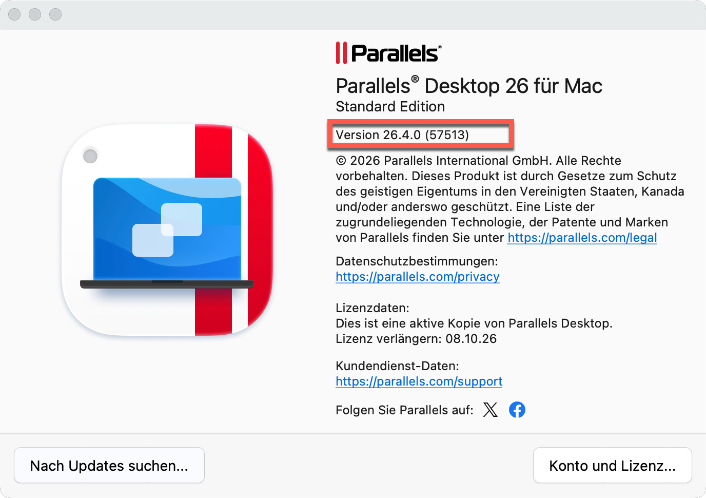

Please first check if you are using the current version of Parallels Desktop:
There were some issues with OpenGL support a few versions ago, which have now been resolved.

I have the current version of Parallels. It always just shows the crash report from Parallels. The Mesa Renderer should be disabled via Disable Software Renderer in the Explorer. The project is still very small because I can't proceed beyond the load input. How can I best send you the file?

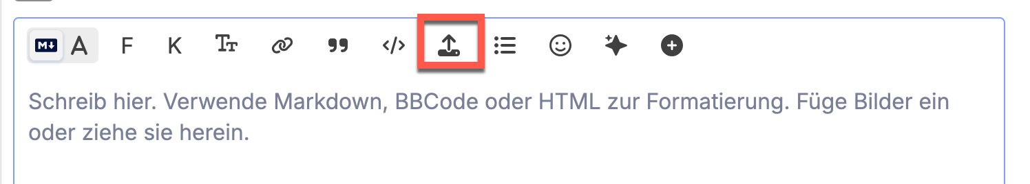

The best way is to upload the file directly in a reply here in the thread.

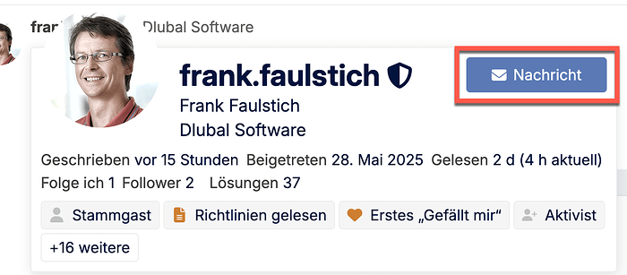

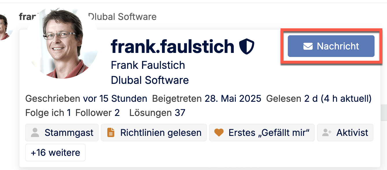

If you don't want to do that, you can also send me a private message. To do this, click on my name and then on Message.
