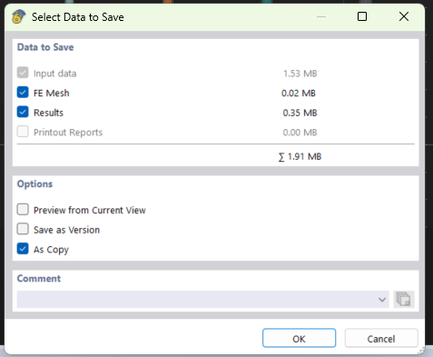

This will open my template model and save it under different name. The original template is closed and the copy is kept open and active. But I need to continue processing the original template file and make more changes to it. The copy shouldn't be modified further; it is like a snapshot.
When doing it through GUI, it keeps the original file active, not the saved one. Also, in the legacy API, it was possible to save it in this way.

Hi janel-cz,
Unfortunately, this function is not yet available in RFEM 6. It has already been considered during development, and we evaluate to make it available in RFEM 6 in the future. However, I cannot provide a timeline for its implementation.
