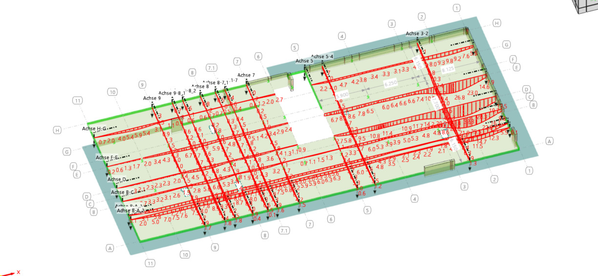

Section cuts for deflections within a plate:

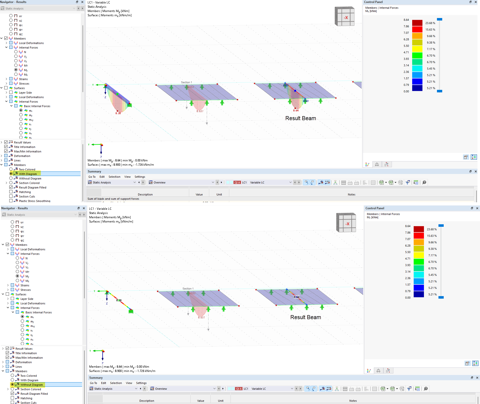

The "rainbow spectrum" or the "results color scale" is not available for result sections, only for members and surfaces. I will add this feature request for the development.

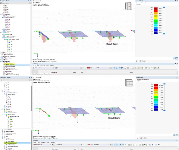

For now, the only option is to work with result beams for certain internal forces:

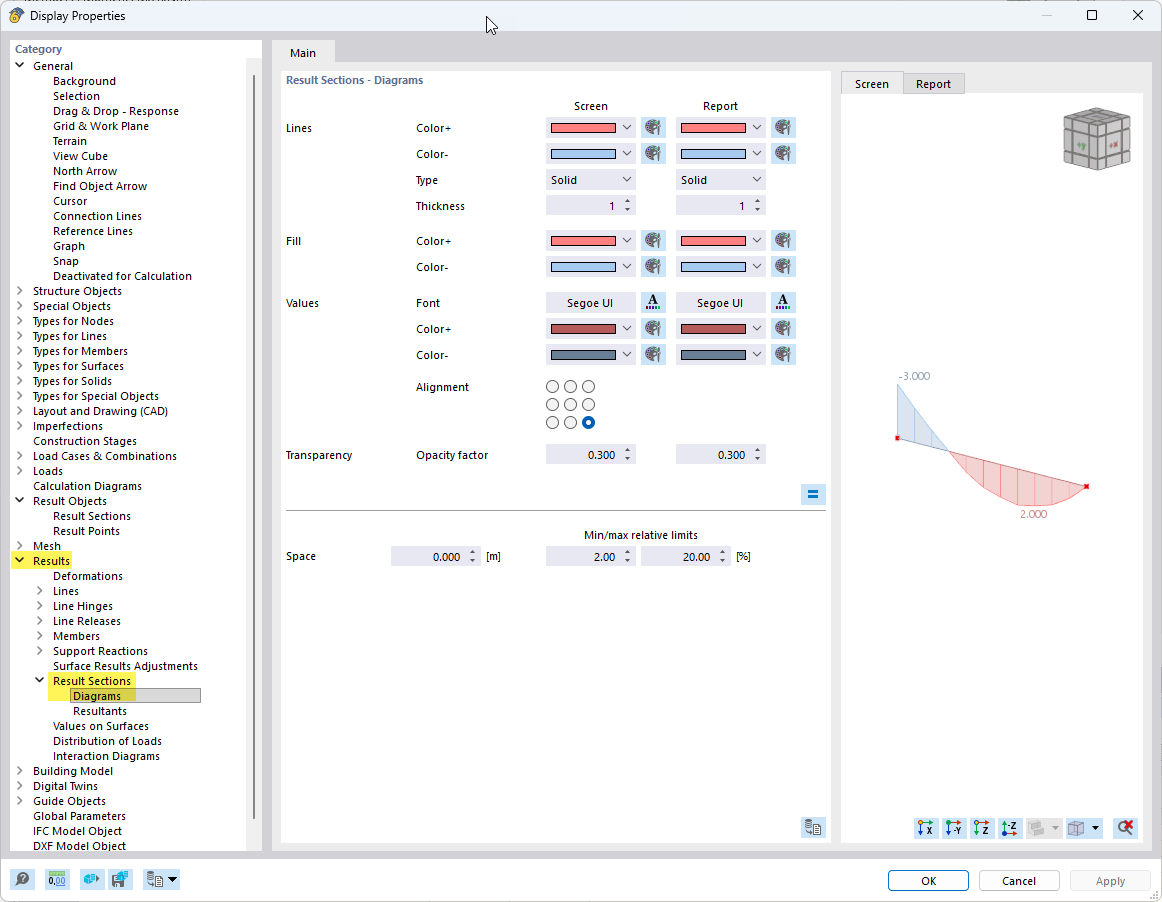

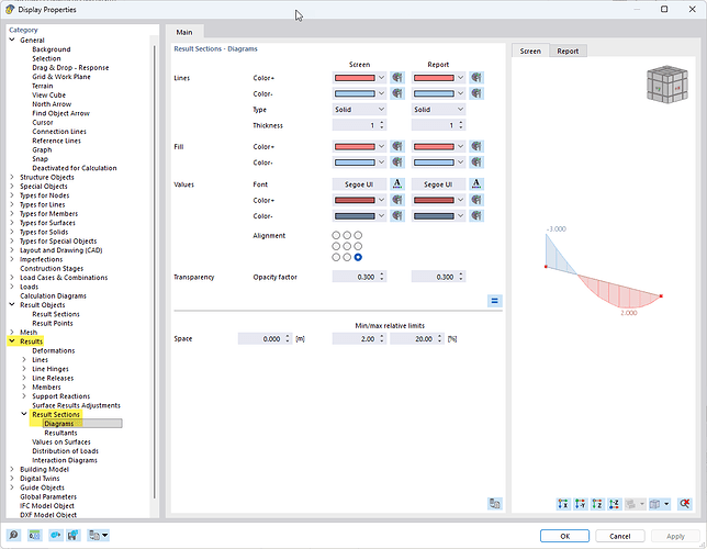

The current display color can be adjusted inside the display properties:
