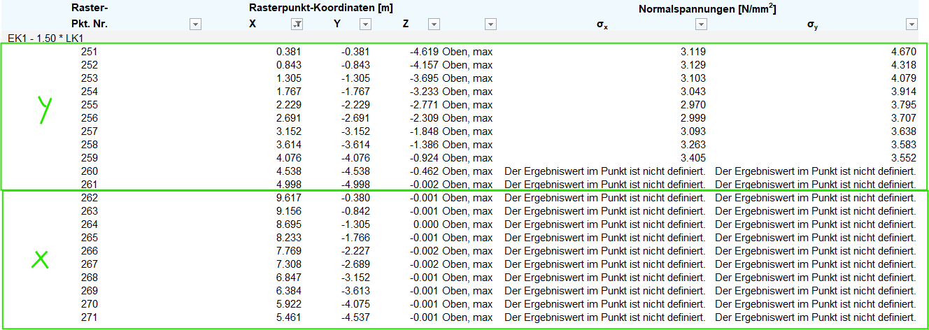

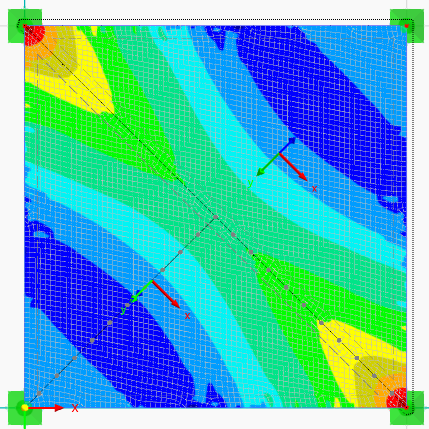

I want to evaluate the stresses at result points on a four-point sail. The points are each located centrally in the local x- or y-direction at a distance of 0.80 m. These result points should be output in the print report. Since there is a large number of load combinations, manually reading the values is unfortunately not an option.
When I export the print report to Excel and filter by the result points, the results for the points in the local y-direction are only output from the edge up to the third-to-last point before the center. For the remaining points, the message appears instead:
"The result value at the point is not defined."
I have already tried slightly shifting the affected result points from the centerline – unfortunately without success.
Does anyone have an idea what could be causing this behavior or how the problem can be solved? I would be very grateful for any tip, as I need to complete the evaluation promptly.
Thank you very much in advance!
Segel Kopie 2.rf6 (8.9 MB)

Could you also please describe in more detail how you arrived at the table shown in the screenshot? Currently, I suspect the following procedure:
  1. Export of print protocol 2 as HTML
  2. Opening the HTML file in Excel
  3. Applying the corresponding filters
Is the message “The result value at the point is not defined” displayed for the affected cells even without applied filters in the Excel table?
Thank you very much in advance! :blush:

I reached the table in the screenshot exactly as you described.
Even without the filter set, the message "The result value at the point is not defined" is displayed.
