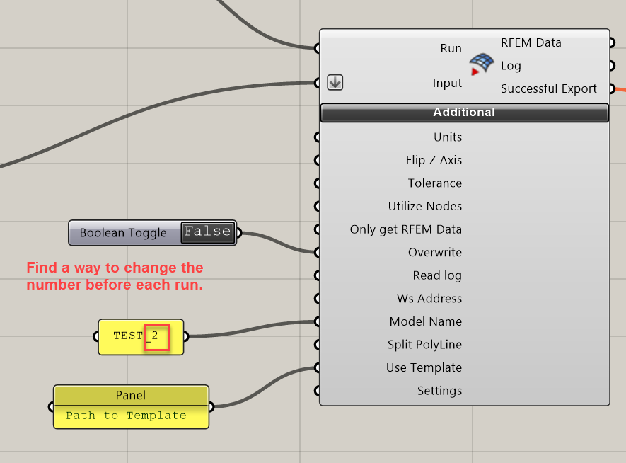

→ Create a new file → Load information from Template → Overwrite all information → Write data from GH Script into RFEM
So all the info from your template are gone. Therefor “Overwrite” has to be set to “False”.
So how could you run the export multiple times?
  1. You could change the name of the model file before each run. If that can be secured, each export creates a new RFEM file.
  1. We have a component that can close an active RFEM file:
Maybe you find a way to implement it into your workflow, that it will be executed before another export-attempt.
