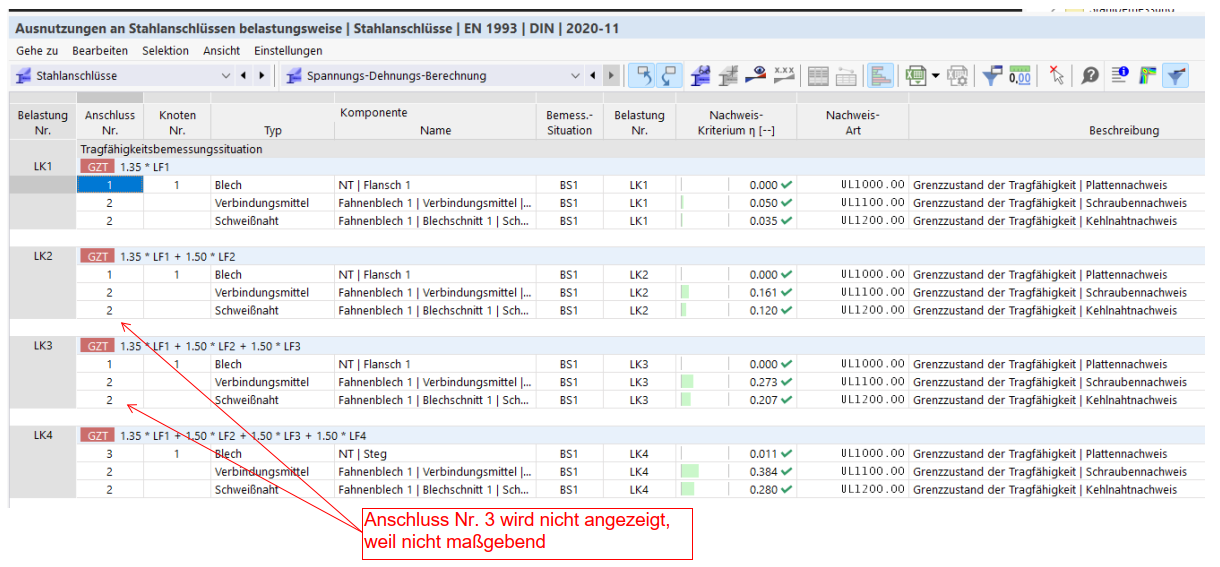

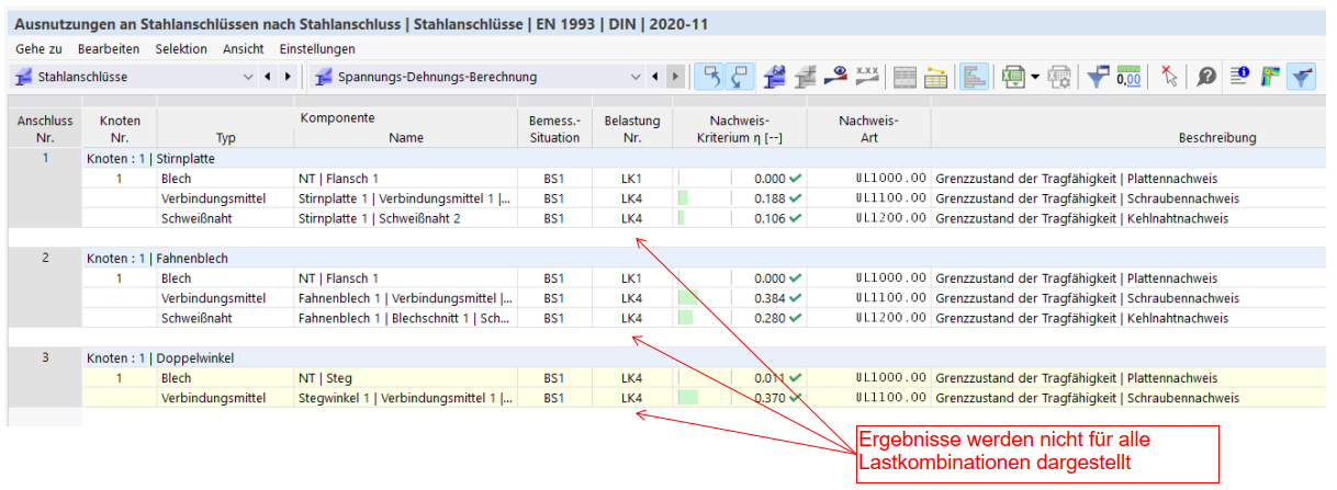

if a node is currently assigned several steel connections, only the results of the respective governing connection are displayed in the connection calculation results. As a result, it is not clear which utilization the more load-bearing connection achieves in a specific load combination.
A desirable result presentation would be similar to that of the structural calculation, where all results for each load combination are visible. This would allow the connections to be directly compared for each load combination.
Furthermore, this serves not only to identify the governing load combination but also other load combinations that have lower utilizations but also lead to a high utilization.

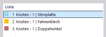

Steel connections:
Results | Utilizations by load:
Results | Utilizations by connection:
