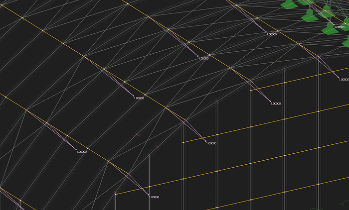

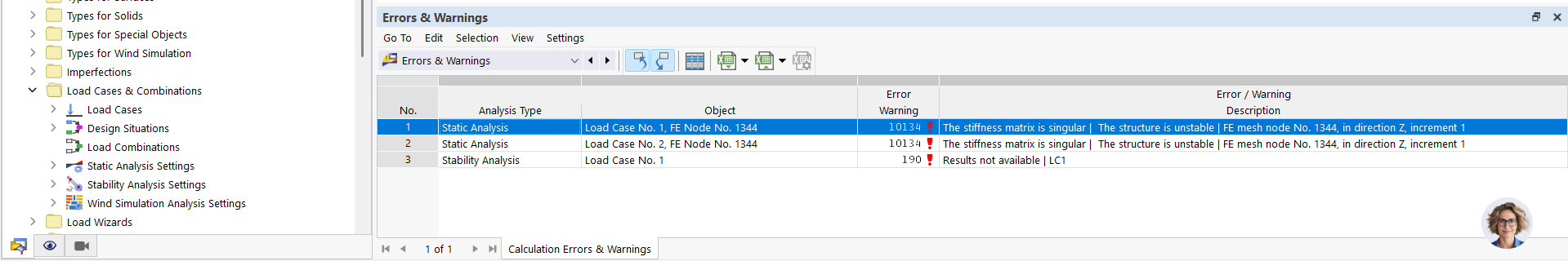

I am currently working on a structural model in RFEM 6. However, when running the analysis, several structural instability errors occur at multiple nodes.
I have made several attempts to resolve the issue, including removing the applied loads, but the error still persists.

Hello Fatima,

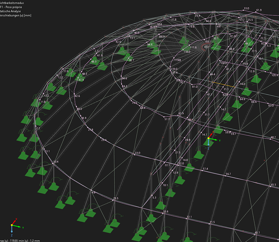

your model is unstable because the bars were modeled as "truss member only N". This type of member cannot carry shear forces. Already due to the self-weight of the members, the bars experience a shear force that they cannot carry because of the member type.

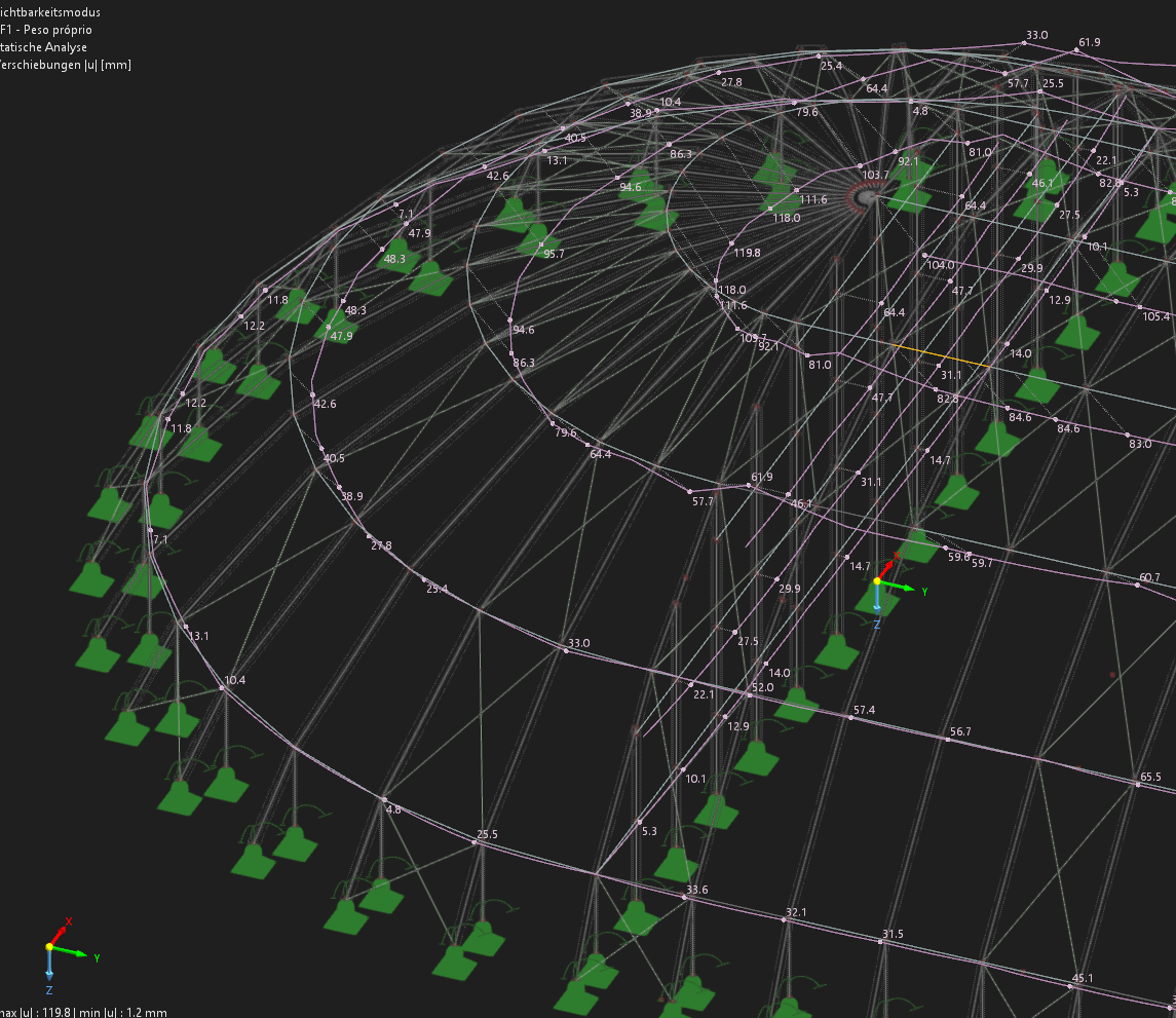

If you change the member type to "truss member", the model will be stable under load case 1. However, the structure still fails in the load combinations because the deformation becomes too large:
You should reinforce the structure (e.g., by using a more massive cross-section for the truss members).
