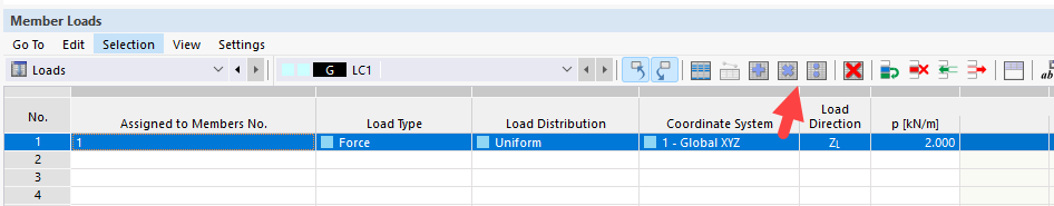

Hi pavel,
thanks for your answer. I was also thinking about the issue and saw, that you can as well multiply (1) load type in the table:
I am just wondering, what purpose may be the reason to adjust every load type in general?
