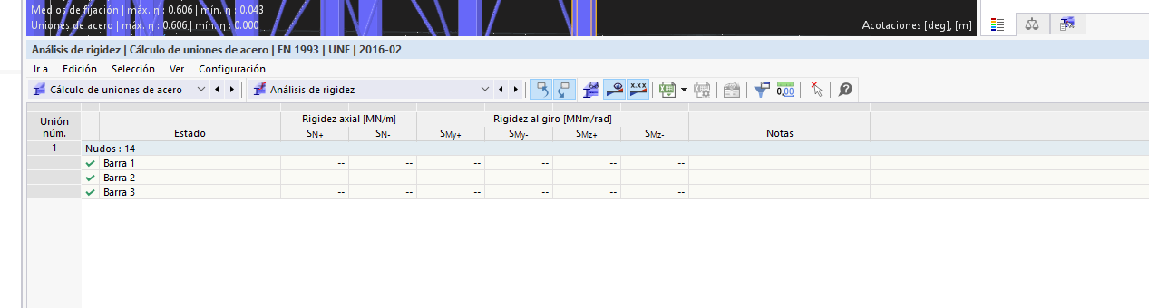

After activating the stiffness analysis and calculating the steel modulus, the results come out blank and I don't know why. I have no errors or warnings.

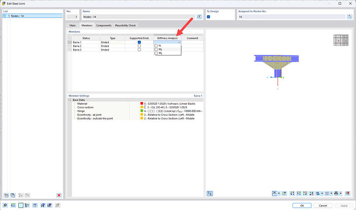

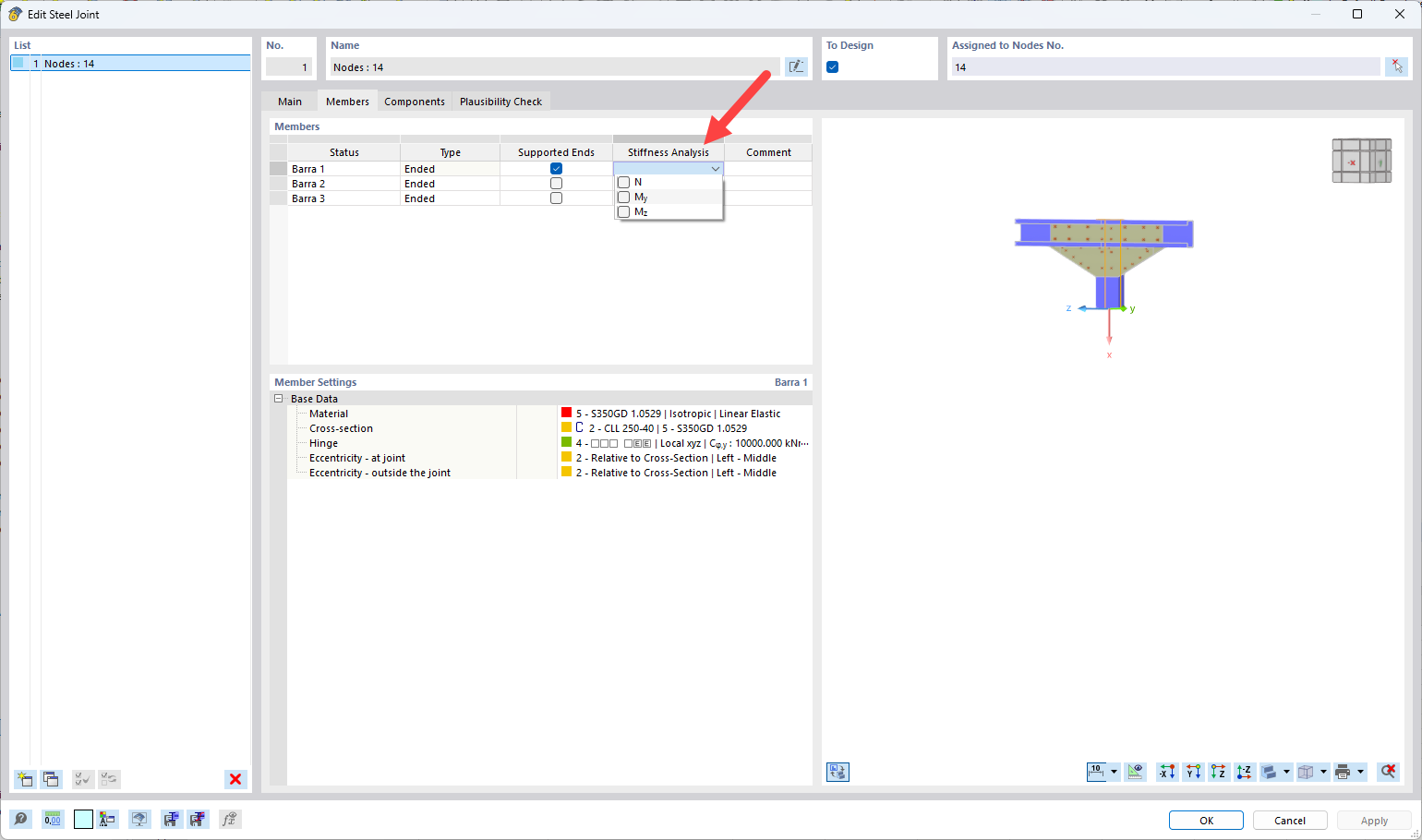

Hi FelipeDosset,
to receive the values, you also need to enable this option in the Members dialog:
https://www.dlubal.com/en/downloads-and-information/documents/online-manuals/rfem-6-steel-joints/003647
