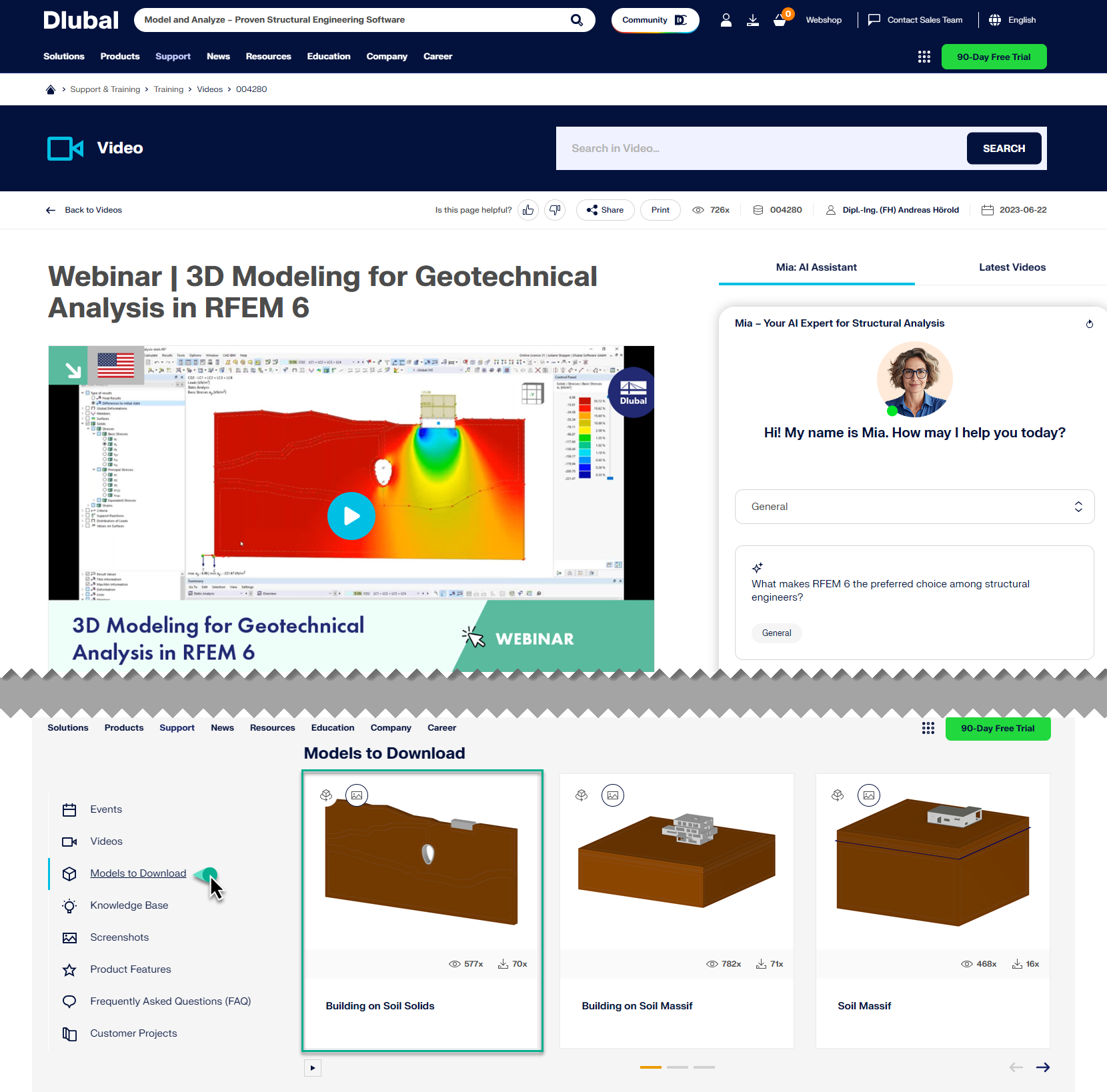

Thank you for providing these webinar links! If literature is referenced in the videos, it should be listed in the additional materials at the end. If no literature is listed, these are examples created by our engineers for demonstration purposes.
Ok Thanks A Lot.. Sir That (examples created by our engineers for demonstration purposes) can i Validate That ?.. From Your Side Any Proof For That..
Sir if Literature Not Available I want to Validate Model in Webinar / Demostration Model ... Any Proof Made By Your Side For my External Viva Exam sir.. I will Watch Webinar and Make same Model from video and i will validate it but for Proof of validate from Your side is much need or Good / Benefical..
Most webinar models are available for download. You can find them by scrolling down and clicking on “Models to Download”. Also you can find in this section more related information.
