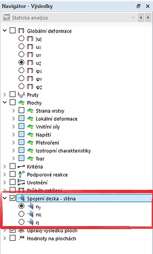

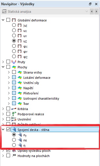

When I use the wall–slab linear connection from the masonry design add-on, a new result section appears (see the figure below). If I understand correctly, this shows the applied vertical force (ny), the vertical bearing capacity (nR), and some utilization factor (eta), but I haven’t found any documentation on this. Where does the bearing capacity value (nR) come from, and what does it mean for my design if the program cannot calculate the bearing capacity or if the utilization factor exceeds 1.0, could this introduce errors into the calculation?

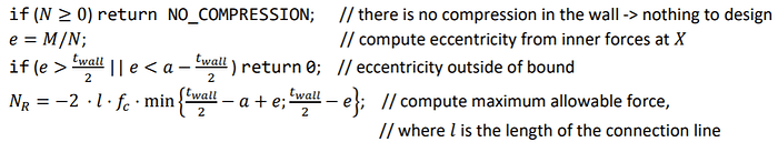

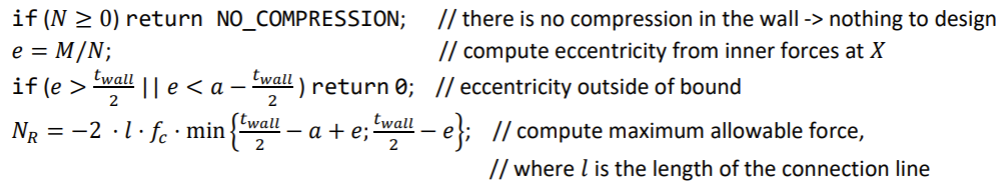

For transparency, here is a short explanation of how the value was originally calculated:
Due to the nonlinear material model, the ratio cannot exceed 1.0.
