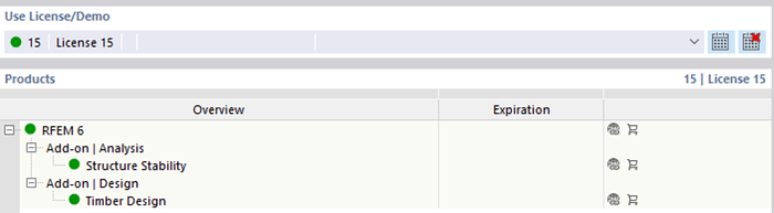

This is what I see when I open the license manager in RFEM
Hi marciosarto,
wer're already working to support the .NetFramework for the API II. Would this help you to start with the API II instead of the API I?
The Company ID 363118 does not exists, please double check.
