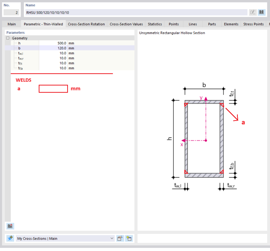

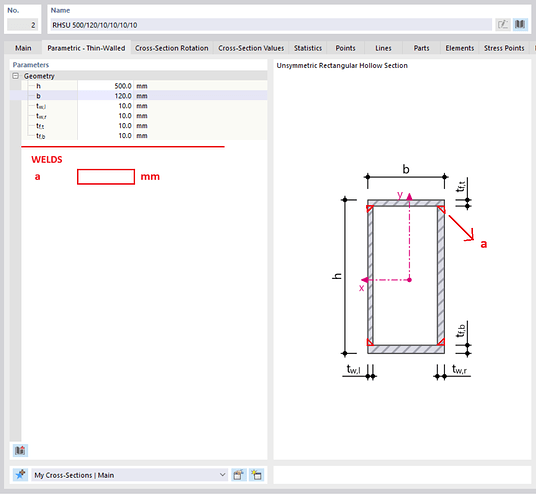

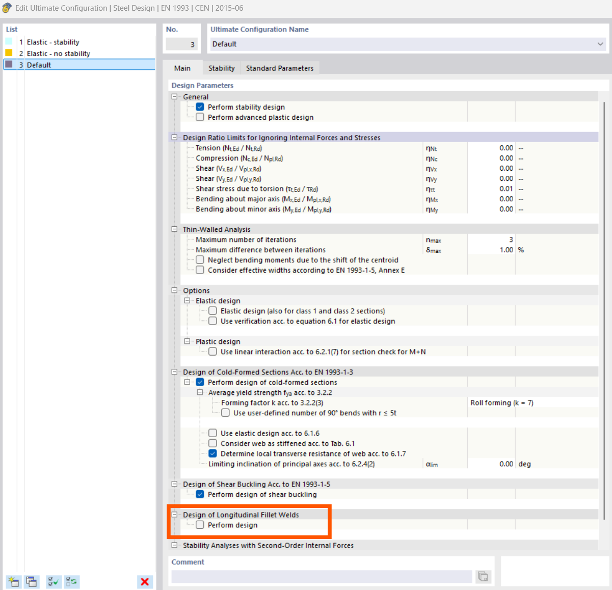

Would be nice a new feature to be able to verify welds of type tee-joint_bevel on some types of welded cross-section, and also add the checks of this verifications on the profile welds steel design according to EC3 (it is already possible to do this verifications for welds of type tee-joint_fillet)
For example, in the picture below, a common need for this type of welds is for welded rectangular hollow sections.

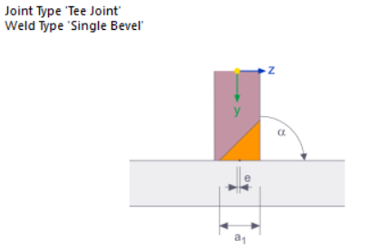

Yes, the idea was to be able to check the option of partial penetration welds in order to optimize the needed weld size for members, with a previous defined cross-section that allow us to define the parameter of the weld size.
For example, to be able to try a bevel weld size of 3mm in a plate thickness of 10mm, and design it with the steel design add-on with an equivalent option for Design of Longitudinal Welds, as we already have for fillet welds type.
