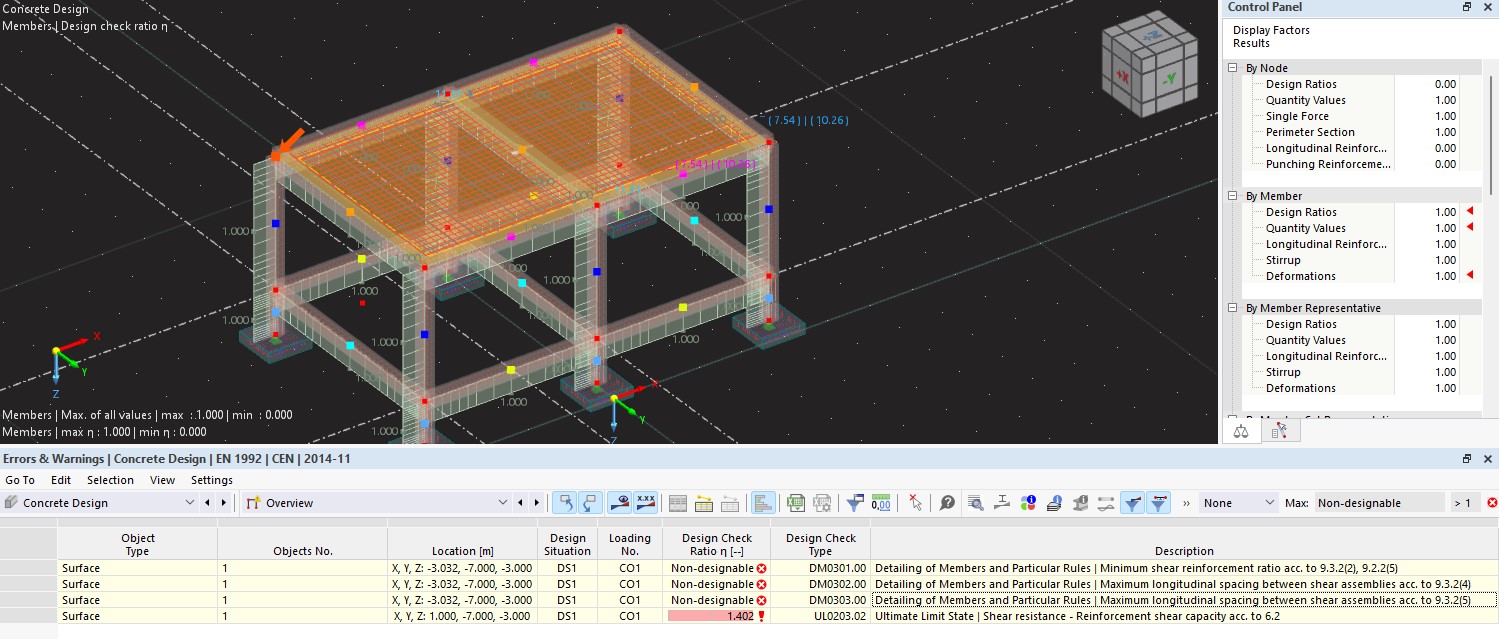

Why shear errors appear for the slab?
The slab thickness is sufficient as I see, and shear r/f is not needed for slabs usually. Reinforcement net is top and bottom so, it’s also sufficient for a test run. Why these errors appear then?
Project file

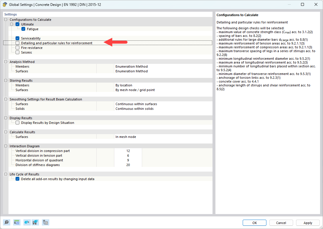

In general, you can control whether the structural detailing requirements for shear reinforcement are checked, even if no shear reinforcement is required based on the calculations.
:gear: Customization Options
If you do not want these detailing checks to be performed in such cases, you can simply disable this option in the global settings.
May be I’m not getting what you suggested me to do properly. As I understand from that screenshot, you’re just asking the software to “Do not check all reinforcements”. Then why we need a software if we do not check anything?
Does the software even have something more specific like “Do not check shear reinforcement”? So we check all other reinforcement and specifically disable shear checks?
I don’t see your suggestion as a solution, that’s just running away from the problem isn’t it?
I feel like software is not capable of disabling only the shear reinforcement, or software is incorrectly calculating reinforcement checks, as I have provided more than enough thickness for the slab, there can’t be any shear failures and shear reinforcements are not required for the slab of that size.

You can control whether shear reinforcement should be avoided if the longitudinal reinforcement is sufficient.
However, if the longitudinal reinforcement is not sufficient—often the case near areas prone to punching shear—you may receive a high utilization ratio, as shown in your screenshot. :warning:
:white_check_mark: What You Can Do:
  • Refine the FE mesh in the critical area
  • Check for punching shear at that location
This often helps improve the accuracy of the results and can reduce unrealistic stress concentrations.
