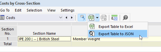

Is there a way to access the "Costs" table of the lower menu in RFEM 6 via the Dlubal API? I couldn't find a method for this in the documentation.
grafik
The background is that this table clearly contains the quantity information for each cross-section.
I would be very grateful for a tip!

It is not yet possible to access these tables via the API. We are happy to take this as a customer request.
So far, there is the option to save them manually as xlsx or JSON files.
