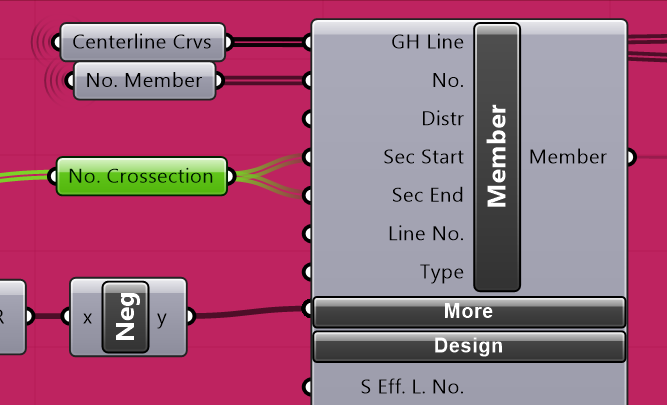

Is there a way via the API to explicitly assign a Cross Section Number during "Import from RSECTION" – similar to what is possible in Grasshopper?

(The Member/Cross Section assignment I control in Grasshopper.)
Since the cross sections are currently still being optimized and adjusted, it would be helpful for my workflow if I could assign a fixed Cross Section No. during import so that existing cross sections in the model can be specifically overwritten.
