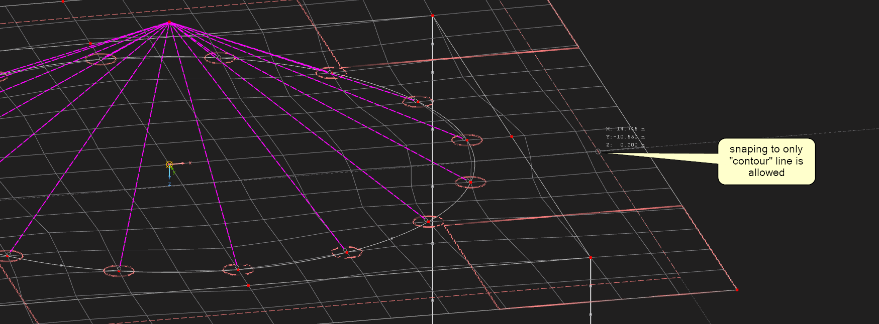

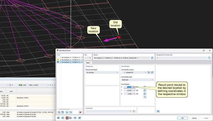

It is not possible to define a result point in a random location on a surface. The program allows to snap to the surface "contour" line which is not even surface edge. After placing point, the coordinates should be changed manually to have desired location. Am I doing anything wrong?

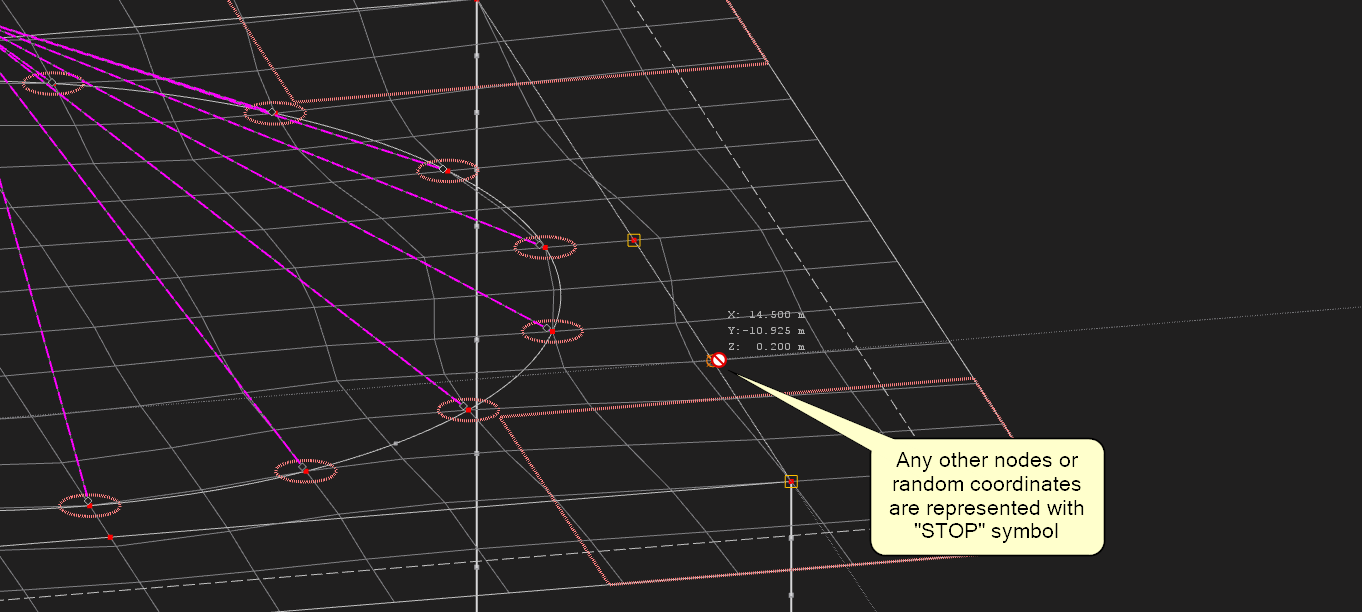

No other nodes or "nearest" points can be selected in graphic interface
