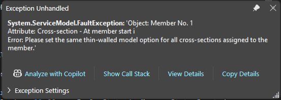

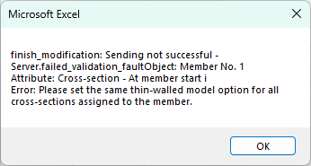

I have working VBA excel tool and C# console app that automates creation of model using Webservice API I (SOAP).
Both of the above tools are working with RFEM 6.11/RSTAB 9.11 versions and below without any error. But in an unknown reason they do NOT work with 2026 release versions 6.12/9.12 and above.
Nodes and lines were created but when the members are being modeled, I got the error on both VBA and console app as shown on the screenshots below. The error shows when it starts to create the members. In my VBA tool, there is already a template where the sections were already generated, and the cross-section number is assigned to those members. It’s just strange that it does not work with the latest versions.
VBA excel tool:

Console App:

Hi isomer.0h,
first of all: Welcome to the Community!
About your issue, I guess it has to do with the renaming of Section to CrossSection in RFEM (v. 6.12 and newer).
I guess you have to modify your code if you want to use the newer versions.
I hope this helps.
Hi Robert,
You are right, I changed section to cross section, and both works now.
Now my problem is solved. Thank you.
